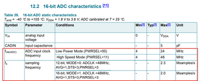

Hi!
I'm configuring ADC Conversion in my LPC5504.
Currently the configuration is the following:
* Main Clock: 96MHz
* ADCK Configuration:
  - CLOCK_SetClkDiv to Prescaler = 2   (48MHz)
* 10 conversion operations:
  - 9 with 35 ADCK cycles total sample time
  - 1 with  131 ADCK cycles total sample time
* Conversion start trigger:
  - Callback function in PWM at 10KHz
This is already working.
In the document from the NXP Knowledge base "ADC multi-channel sampling and DMA transfer in LPC55xx" it is said that maximum frequency is 24MHz but as I said we selected ADCK to 48MHz.
Question #1 Should we set a smaller prescaler (4 instead) according to this limitation or we could even use prescaler=1 ?
In this same document and in the user manual it is said that maximum sample conversion is 1 Mega samples per second. In our case we are doing 10 conversions at 10kHz which are 100,000 conversions pers second
Question #2 should I understand that we are still under the limitation of 1MSPS ?

Hello @pejo
For details about the ADC clock frequency and sample rate, please refer to the Datasheet.
Thank you.
