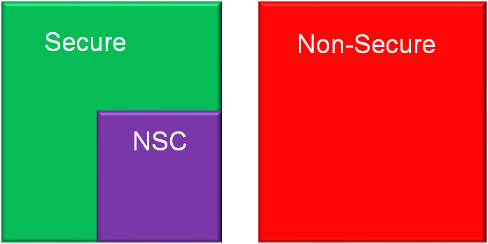

The Secure memory space is further divided into two types: Secure and Non-secure Callable(NSC).
Below are the feature/properties of Trustzone memory regions ( S, NS, NSC ):

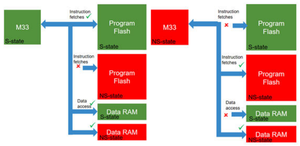

  • Secure (S) - For Secure code/data
− Secure data can only be read by secure code
− Secure code can only be executed by CPU in secure mode
  • Non-Secure (NS) – For non-Secure code/data
− NS Data can be accessed by both secure state and non-secure state CPU
− Cannot be executed by Secure code
  • Non-Secure Callable (NSC)
− This is a special region for NS code to branch into and execute a Secure Gateway (SG) opcode.

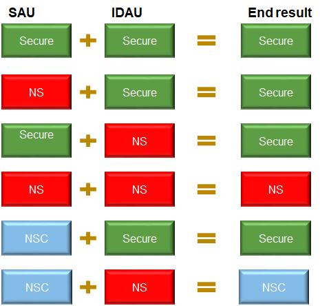

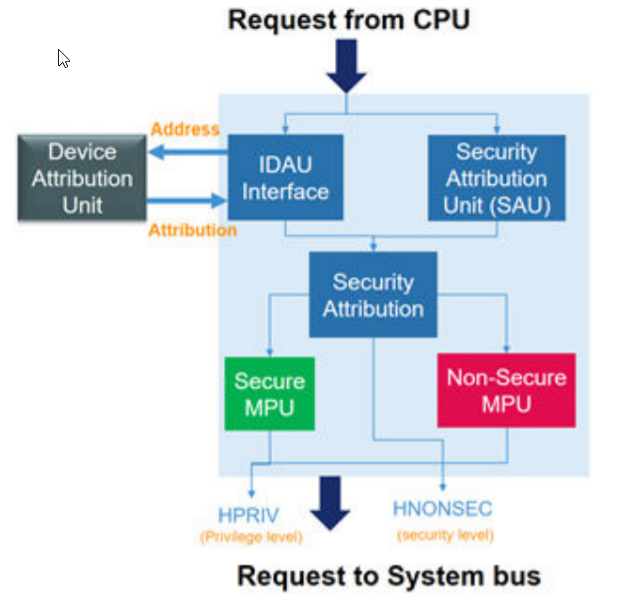

Combination of Security SAU and IDAU assign a specific security attribute  (S, NS, or NSC) to a specific address from the CPU0. Device Attribution Unit (DAU) connects to CPU0 via IDAU interface as show the following Figure. Access from CPU0, dependent on its security status and the resultant security attribute set by the IDAU and SAU, is then compared by the secure AHB Controller to a specific checker which marks various access policies for memory and peripherals. All addresses are either secure or non-secure. The SAU inside of the ARMv8-M works in conjunction with the MPUs. There are 8 SAU regions supported by LPC55S69.
Secure and non-secure code runs on a single CPU for efficient embedded implementation. A CPU in a non-secure state can only execute from non-secure program memory. A CPU in a non-secure state can access data from both NS memory only. For the secure, trusted code, there is a new secure stack pointer and stack-limit checking. There are separate Memory Protection Units (MPUs) for S and NS regions and private SysTick timers for each state. The secure side can configure the target domain of interrupts.
The NXP IDAU (Implementation specific Device Attribution Unit) implementation of ARM TrustZone for core0 involves using address bit 28 to divide the address space into potential secure and non-secure regions. Address bit 28 is not decoded in memory access hardware, so each physical location appears in two places on whatever bus they are located on. Other hardware determines which kinds of accesses (including non-secure callable) are allowed for any address.  The IDAU is a simple design using address bit 28 to allow aliasing of the memories in two locations. If address bit 28 is = 0 the memory is Non-Secure. If address bit 28 = 1 the memory is Secure.
The SAU allows 8 memory regions and allow the user to override the IDAU’s fixed Map, to define the non-secure regions. By default, all memory is set to secure. At least one ASU descriptor should be used to make IDAU effective. If either IDAU or SAU marks a region, then that region is secure. NSC area can be defined in NS region of the IDAU.

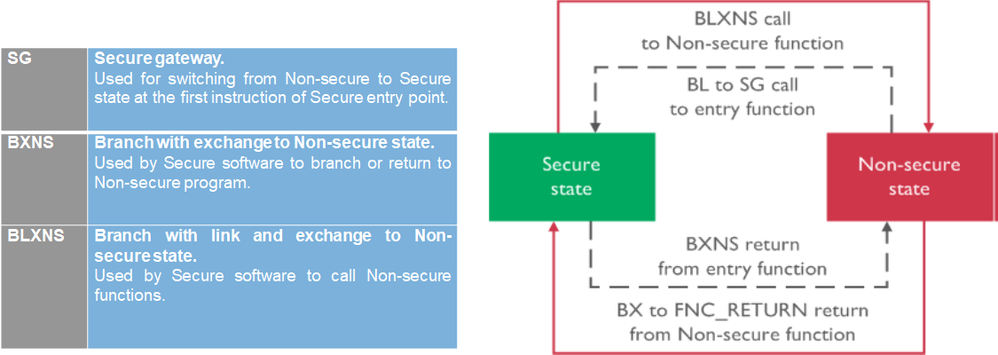

The system boots in secure state and can change security states using branches as summarized in the following Figure.
Transitions from secure to non-secure state can be initiated by software through the use of the BXNS and BLXNS instructions that have the Least Significant Bit (LSB) of the target address unset.
Note: The M profile architecture does not support the A32 instruction set. This allows the LSB of an address to denote the security state.
Transitions from non-secure to secure state can be initiated by software in two ways:
  • A branch to a secure gateway.
  • A branch to the reserved value FNC_RETURN.
A secure gateway is an occurrence of the Secure Gateway instruction (SG) in  the Non-Secure Callable (NSC) region. When branching to a secure gateway from non-secure state, the SG instruction switches to the secure state and clears the LSB of the return address in lr. In any other situation the SG instruction does not change the security state or modify the return address. A branch to the reserved value FNC_RETURN causes the hardware to switch to secure state, read an address from the top of the secure stack, and branch to that address. The reserved value FNC_RETURN is written to lr when executing the BLXNS instruction. Security state transitions can be caused by hardware through the handling of interrupts. Those transitions are transparent to software and are ignored in the remainder of this document.
