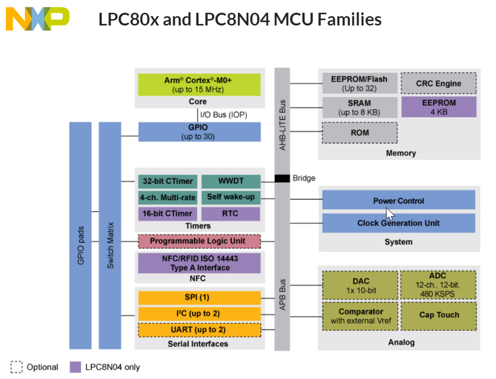

This document is an introduction to the Programmable Logic Unit (PLU) provided for the LPC804 MCU device.
PLU is used to create small combinatorial and/or sequential logic networks including simple state machines. This allows to replace external components like the 74xx series, which are used for the glue logic with the microcontroller and external devices, making simple the PCB and saving design costs.
Figure 1. LPC80x MCU families

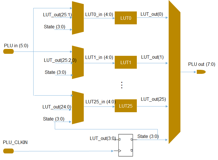

The PLU is comprised of an array of 26 inter-connectable, 5-input Look-up Table (LUT) elements, and 4 flip-flops.  Each LUT element contains a 32-bit truth table (look-up table) register and a 32:1 multiplexer. During operation, the five LUT inputs control the select lines of the multiplexer. This structure allows any desired logical combination of the five LUT inputs.
Figure 2. PLU

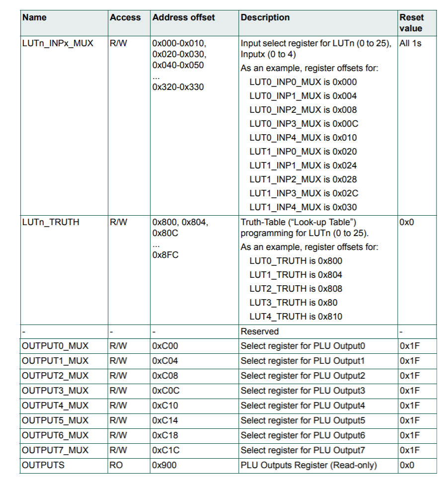

Registers
Programming the PLU to implement a particular logic network involves writing to the various Truth Table registers to specify the logic functions to be performed by each of the LUT elements, programming the Input multiplexer registers to select the five inputs presented to each LUT, and programming the Output multiplexer register to select the eight primary outputs from the PLU module.
Programming of all of these registers is performed only during initialization.
Table 1. PLU registers

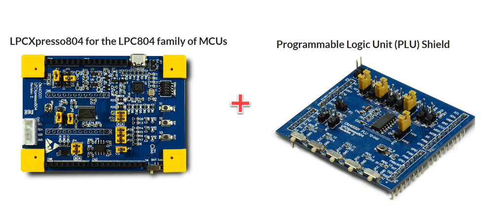

PLU Shield board with LPCXpresso804
The OM40001 package includes a shield board for use with the LPCXpresso804 board when prototyping programmable logic unit (PLU) designs. The PLU shield provides the following features to assist with this type of development:
  • 5 slide switches to enable 5 possible PLU inputs to be connected to VDD (marked as VCC on the Shield) or GND through a resistor (to set those inputs to a logic 1 or zero).
  • 8 LEDs with jumpers to connect/disconnect possible PLU outputs for visual status indication.
  • Push button option for momentary / edge signal inputs.
  • Low-frequency oscillator with 1024Hz and 8Hz outputs.
The PLU shield also includes a test circuit that can be used to implement a simple continuity tester.
Several signals from the LPC804 used on the PLU Shield are shared with other functions on the main LPCXpresso804 board. Please review jumper settings on the LPCXpresso804 board carefully before installing the PLU Shield.
https://www.nxp.com/docs/en/user-guide/UM11083.pdf
Figure 3. LPCXpresso804 + PLU Shield = PLU demo board

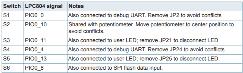

PLU input options
On/off switches S1 through S5 connect possible PLU inputs to VDD or GND via a resistor, enabling those inputs to be driven to a known, fixed state. PIO0_8 is connected to a push button (S6) and a 100kohm pull up to VDD; PIO0_8 will be grounded when the button is pressed. Table below shows these connections.
Table 2. PLU input on/off switches.
A digital oscillator circuit is also included on the Shield, with 1.024kHz and 8Hz outputs available. LPC804 signal PIO0_1 can be connected to these oscillator signals in order to provide a low-speed clock to the flip-flops in the PLU block. The center pin (2) of JP12 connects to PIO0_1, so a jumper can be placed onto JP12 to connect this signal to the required clock (see markings on the Shield silk screen.) An external clock can be provided to the PLU by connecting it to the center pin of JP12.

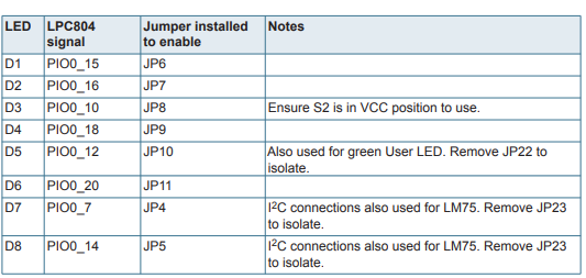

PLU output options
LEDs are used to monitor the PLU outputs. Due to the limited number of pins on the chip/board, some of the inputs and outputs are shared.
Table 3. PLU shield LEDs.
