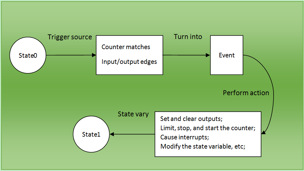

      The first time you look at the SCTimer/PWM, it may appear to be a very complex peripheral, but you will see that it is actually not that difficult to use. Understanding the Event and State is critical to understanding the SCTimer/PWM.
       Event:
       The following conditions define possible events: a counter match condition, an input (or output) condition, a combination of a match and/or an input/output condition in a specified state, and the count direction. Events can control outputs, interrupts, DMA requests and the SCTimer/PWM states. They can also cause timer limit, halt, start, or stop conditions to occur.
       State:
        The state variable is the main feature that distinguishes the SCTimer/PWM from other counter/timer/PWM blocks. Events can be made to occur only in certain states. Events, in turn, can perform the following actions:
a)    Set and clear outputs;
b)   Limit, stop, and start the counter;
c)    Cause interrupts;
d)   Modify the state variable;
        Regarding the event and state mechanism (Fig 2 show a basic example), The SCT allows the user to group and filter events, thereby selecting some events to be enabled together while others are disabled. A group of enabled and disabled events can be described as a state, and several states with different sets of enabled and disabled events are allowed. Changing from one state to another is event driven as well and can happen without software intervention. Formally, the SCTimer/PWM can be programmed as state machine generator. The ability to perform switching between groups of events provides the SCT the unique capability to be utilized as a highly complex State Machine engine. Events identify the occurrence of conditions that warrant state changes and determine the next state to move to. This provides an extremely powerful control tool - particularly when the SCT inputs and outputs are connected to other on-chip resources (comparators, ADC triggers, other timers etc.) in addition to general-purpose I/O.
Fig 2

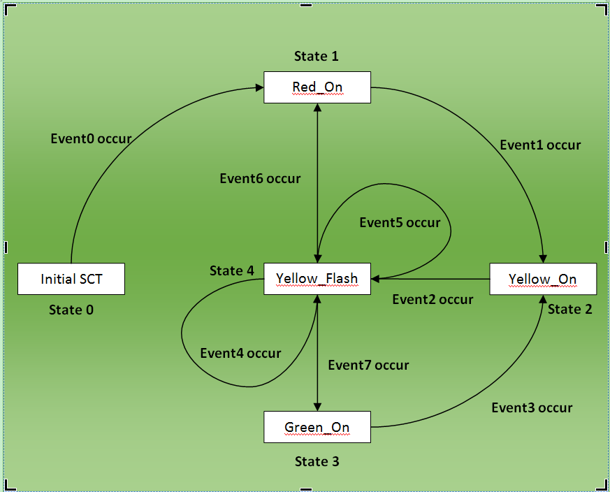

Traffic signal implementation
            Fig 3 illustrates the application of the SCT to simulate the traffic signal.
Fig 3

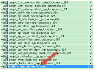

  1.              Creates a new project
Fig 4

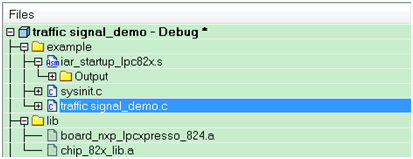

2.    Create the example and lib groups, then add the startup and board initialization files under the example group and add the library files: board_nxp_lpcxpresso_824.a and chip_82x_lib.a under the lib group. Next, create a main.c file: traffic_signal_demo.c.
Fig 5

/* STATE registers */
LPC_SCT->STATE_L = 0;
/* state names assignment: */
  /* State U 0: U_ENTRY */
  /* State U 1: RED */
  /* State U 2: YELLOW */
  /* State U 3: GREEN */
  /* State U 4: YELLOW_FLASH */

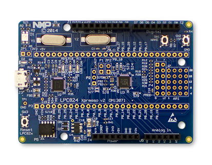

v Result demonstrate
         The demo runs on the LPCXpresso824-MAX board, and using the Blue led replaces the Yellow led, and the video shows the demo working.
Fig 7 LPCXpresso824-MAX board
