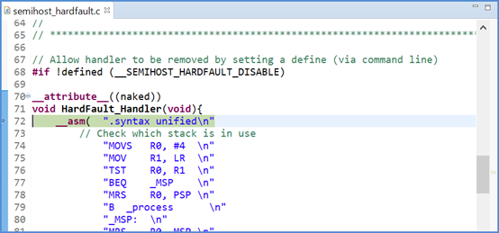

Recently I have several customers experience HardFault error when perform AHB FLASH memory read on LPC55S69. If a FLASH sector has never been programed after mass erase, performing AHB reads of the FLASH memory contents will cause a hardware fault if an unrecoverable error is detected.
Why?
LPC55Sxx parts are delivered from the factory mass erased with ECC unset. When MCUXpresso IDE connects a chip via LinkServer, it will firstly erase the sectors that will be used for the image being programed, then program the code with a correct ECC set. The sectors beyond the end of the image will be left unchanged, which keep in “erased” states without ECC set on them.
When LPC55Sxx executes FLASH read code ( for example, mytemp = *(uint32_t*)0x4000 ) through AHB bus, it checks FLASH ECC while AHB read. No issue to read programed sectors because ECC has already set. But, read unprogrammed sectors with invalid ECC values leads to fail to read and go to HardFault_Handler as below:
If performing AHB reads of the flash memory contents AFTER a sector erase, we will have the same HardFault issue.
