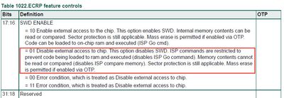

LPC54605:Configure ECRP to 0x00015800. After disabling SWD, it needs to be restored.
When the ECRP value is 0x00015800, we analyze from high to low through  user manual.
In ECRP, 31:18 bits are reserved, and 17:16 bits determine the status of SWD.
In this example, 17:16=01 ,this means that SWD is disabled.
15: 14 =01, it is not allowed to enter ISP through IAP call.
13: 12 = 01, it is not allowed to enter ISP through pin.

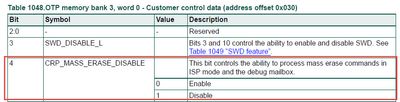

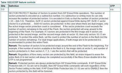

11: 10 = 10, IAP sector erase / write protection is disabled, so sector protect (5:0) is ignored.

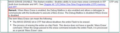

At this point,  SWD (17:16) is DISABLED, ISP Entry from ISP (15:14) is DISABLED, and ISP Entry from Bootloader (13:12) is DISABLED, the IAP Mass Erase can still be used to erase the entire Flash to recover a device. as long as the OTP MASS ERASE is ENABLED. If the OTP has been configured and bit 4 is set to 1, that is, disabled mass erase command, the SWD can never be recovered again.
When Mass Erase is enabled, the Debug Mailbox is also enabled and allows a debugger to communicate with the bootloader to execute a Mass Erase.
Therefore, the Debug Mailbox can be used to perform Mass Erase operation and restore ECRP settings. To achieve the purpose of re-enabling SWD.

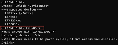

3.1 Use "unlock LPC5460x" command re-enable SWD
If use J-link debug probe, use "unlock LPC5460x" command to re-enable SWD.
  1. Open the J-Link commander and enter unlock to view supported devices.
  2. Enter the corresponding chip command. In this paper, the command is unlock LPC5460x.
As shown in the picture below:
However, for some chips, this method still fails to re-enable SWD. The following is a method of SWD recovery based on LPC-LINK2 CMSIS DAP. If the unlock LPC546xx command does not work, use the following method.

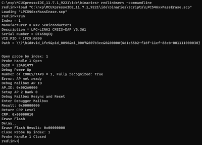

1) Put LPC546xxMassErase.scp script in the path:
C:\nxp\MCUXpressoIDE_11.7.1_922\ide\binaries\Scripts
2) Open a command prompt window.
3) Change the path to C:\nxp\ MCUXpresso IDE v11.7.1_9221 \ide\binaries.
4) Run the redlinkserv -commandline command.
5) After running the redlinkserv -commandline command, you should see the redlink> prompt.
6) Run the load command "C:\nxp\MCUXpressoIDE_11.7.1_9221\ide\binaries\Scripts\LPC546xxMassErase.scp".
7) After executing the load command, you should see that "LPC546xxMassErase.scp" is being loaded.
Execute the run command.
9) After executing the run command, you should see the following message.
In this case, the SWD interface can be used normally.

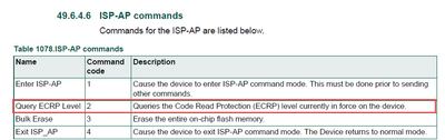

4.Query ECRP level
In the LPC546xx user manual, we can see  ISP-AP command, one function is query the ECRP  level, that is, to view the ECRP configuration of this chip.
From the log in part 3, we can see the returned ECRP level:
However, there is no explanation in the user manual, so here we show the meanings of each bit.

In CRP_MASS_ERASE_DIS_BIT, 0 is Mass Erase allowed and 1 is disallowed. It’s corresponding to the combination of ECRP value bit 0~5, bit 10~11, and bit 14~15.
