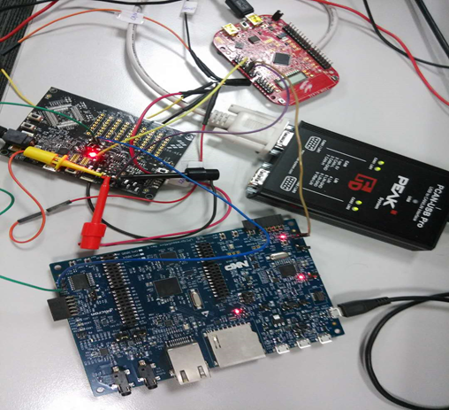

     Now use the LPCXpresso54608 board as the LIN slave, the PCAN-USB Pro FD LIN analyzer as the LIN master, give the hardware connection and the simple software code about the LIN slave.
2.1 Hardware requirement
       HardwareLPCXpresso54608TRK-KEA8PCAN-USB Pro FD(LIN analyzer), 12V DC power supply
       LIN bus voltage is 12V, but the LPCXpresso54608 board don’t have the on-board LIN transceiver chip, so we need to find the external board which contains LIN transceiver chip, here we will use the TRK-KEA8, this board already have the MC33662LEF LIN transceiver, or the board KIT33662LEFEVB which is mentioned in the LPC54608 LIN master post.  The MC33662LEF LIN transceiver circuit from TRK-KEA8 just as follows:

2.1.1 LPCXpresso54608 and TRK-KEA8 connections
     LPCXpresso54608 UART port need to connect to the LIN transceiver:
No.
LPCXpresso54608
TRK-KEA8
note
1
P4_RX
J10-5
UART0_RX
2
P4_TX
J10-6
UART0_TX
3
P4_GND
J14-1
GND
2.1.2 TRK-KEA8 and LIN master analyzer tool connections
       LIN analyzer LIN bus is connected to the TRK-KEA8 LIN bus.
       LIN analyzer GND is connected to the TRK-KEA8 GND.
       TRK-KEA8 P1 port powered with 12V, LIN master analyzer Vbat pin also need to be connected to 12V.
       TRK-KEA8 J13_2 need to connect to 3.3V DC power, but because TRK-KEA8 is the 5V and 12V, so need to find another 3.3V supply to connect J13_2, here use the FRDM-KL43 as the 3.3V supply. Just make sure the LIN transceiver can input 3.3V and output the 3.3V signal to the UART port.
2.1.3 Physical connections

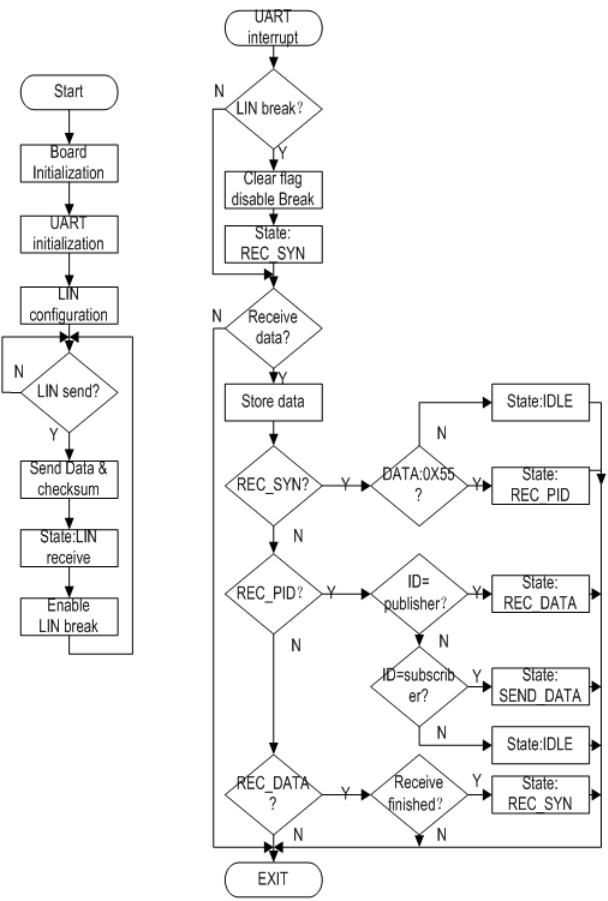

       This part is about the LIN publisher data and the subscriber ID data between the LIN master and slave. The code is modified based on the SDK  LPCXpresso54608 usart interrupt project.
 2.2.1 software flow chart
2.2.2 software code
   Code is modified based on SDK_2.3.0_LPCXpresso54608 usart interrupt, the modified code is as follows:

       if(state == SEND_DATA)
        while (kUSART_TxFifoNotFullFlag & USART_GetStatusFlags(DEMO_USART))
            USART_WriteByte(DEMO_USART, 0X01);
            break;  //just send one byte, otherwise, will send 16 bytes
            USART_WriteByte(DEMO_USART, 0X02);
            USART_WriteByte(DEMO_USART, 0X10);// 0X10 correct 0Xaa wrong
          recdatacnt=0;
          state = RECV_SYN;
          EnableLinBreak;

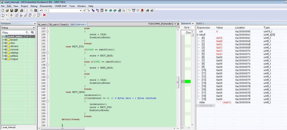

3 LPC54608 LIN slave test result
  Master define two frames
Unconditional ID
Protected ID
Direction
Data
checksum
0X2C
0XEC
subscriber
0x01,0x02
0x10
0X2D
0XAD
Publisher
0x01,0x02,0x03
0x4c
  Now, LIN master send the above two frame to the slave LIN, give the test result and the wave from the LIN bus.

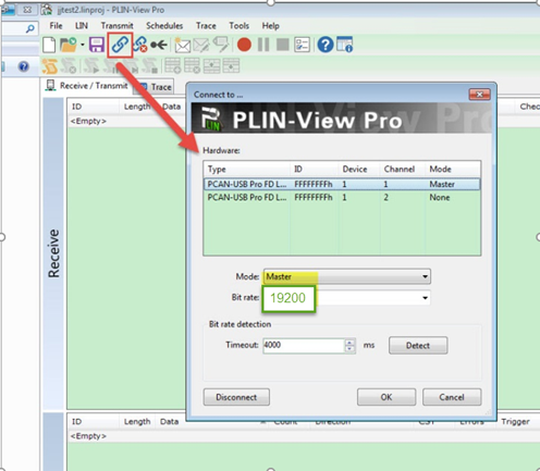

3.1 LIN master configuration
Uart baud rate is: 19200bps
3.2 send 0X2C,0X2D frames

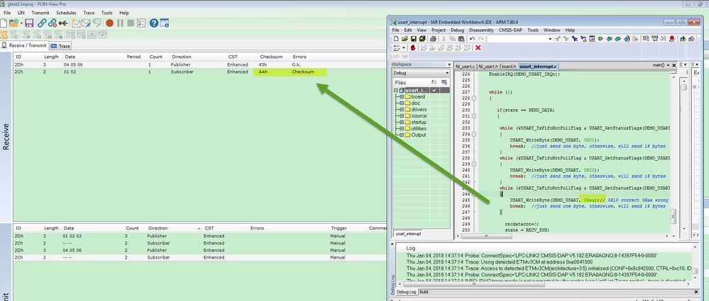

From the above test result, we can find 0X2D send successfully, 0X2C can receive the data from the LIN save side, the received data is 0X01,0X02 and the checksum 0x10.

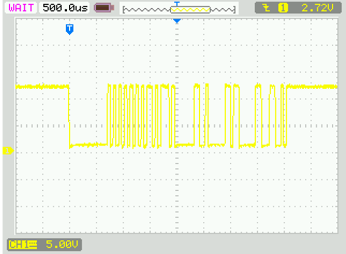

3.2.1 0X2D frame LIN bus wave and debug result
From the LIN slave debug result, we can find LIN slave can receive the correct data from the LIN master, and after check, the checksum also correct.

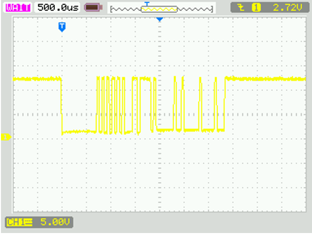

3.2.2 0X2C frame LIN bus wave
From the LIN Master tool interface, we can find if the slave give the wrong checksum 0XAA, the master will also can find the checksum is wrong.
This is the according LIN bus wave with wrong checksum.
From the above test result, we can find LPC54608 LIN slave, can receive the correct LIN bus data, and send back the correct LIN data to the master.
