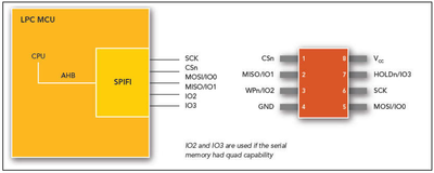

  1. Introduction to SPIFI
SPIFI (SPI Flash Interface) is an SPI Flash interface that can help microcontrollers replace large-size, high-cost parallel Flash with small-size, low-cost serial Flash. Using SPIFI technology, the external serial FLash can be mapped to microcontroller memory to achieve on-chip memory read effect, that is, cost can be optimized and Flash size can be increased while ensuring the operating speed.
The electrical interface of SPIFI is as follows:
In the LPC540XX series of chips, if the part number includes M, QSPI Flash is integrated inside chip; if the part number does not include M, the QSPI Flash is externally connected to chip. The following picture shows the comparison of LPC54S018JXM and LPC54S018 in SPIFI structure:

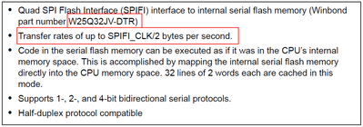

Taking LPC54S018J4M as an example, the SPIFI clock frequency is described below in the UserManual. SPIFI supports 1/2/4bit transmission mode. In 4bit transmission mode, the maximum transmission rate is SPIFI_CLK/2 bytes per second. The data transmission rate is up to 52Mbytes /s, that is, it takes two clock to transmit one byte. If you want to configure the SPIFI transmission rate to 52Mbytes /s, it needs to be in 4bit mode, so SPIFI_CLK is configured to 104M.

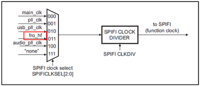

The SPIFI clock source is as follows in LPC54S018J4M Datasheet. By default, the SPIFI clock source is FRO96. For example, when the SPIFI clock is configured to 96M, in 4bit transmission mode, the transmission rate is 96/2=48Mbyte/s.
The LPC54S018J4M uses W25Q32JV-DTR as the internal SPIFI Flash. The figure below shows the maximum clock frequency it supports. In 4bit transmission mode, the maximum transmission rate is 133/2=66.5Mbyte/s, which is greater than SPIFI's maximum transmission rate of 52Mbyte/s. It shows that the maximum data transmission rate of W25Q32JV can meet the requirements of LPC54S018J4M QSPI Flash interface for communication rate.

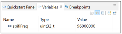

Another method is to modify the SPIFI clock frequency by changing the SPIFI frequency division coefficient in user code, as follows:
The result is as follows. The SPIFI clock frequency is set to 96M.
If you want to configure a higher SPIFI working clock, such as 104M, you must use a higher frequency external clock source to adjust the PLL coefficient and SPIFI frequency division coefficient in order to achieve the required clock frequency.
