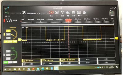

When the above code is running, user can see the blue LED toggles on the LPC55S69-EVK board. Connecting the PIO1_4 pin signal ( the pin 5 of P18 connector) on LPC55S69-EVK, the PIO1_4 signal toggling frequency is 5Hz, the cycle time is 200mS, so the delay is 100mS.
