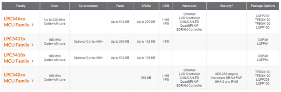

        NXP's recently released the LPC540xx family which continues the trend of high-performance flash-less MCU.

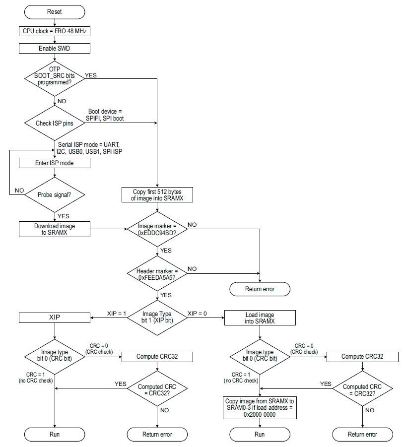

       In the Plain Load and XIP modes, the executable image file is stored in the external flash. After MCU is powered, the bootloader which is resided in ROM copies the first 512 bytes from the image (vector components and image header) into internal SRAMX at location 0x0000 0000 to validate the vector table and image header to confirm the booting mode. And the program will not be lost after power-off or reset. Fig1 illustrates the boot process of LPC54018.
Fig1 LPC54018 boot process flow

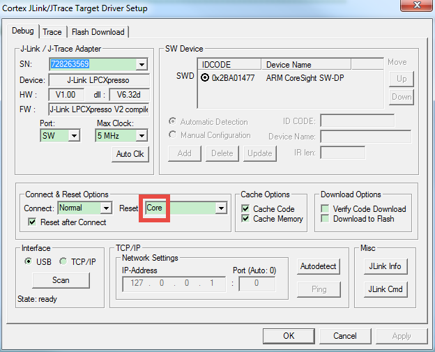

     Note: Setting the Reset: Core when debugging the demo pastedImage_7.png
Fig2 Setting the Reset: Core

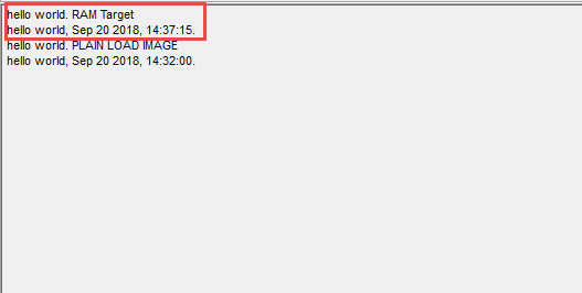

Running testing:
As the Fig3 illustrates, it would print the below message when debugging the demo, however, after reset, it would run the plain load image which is programmed before, as the RAM lost the hello world demo.
Fig3 RAM Target runing testing

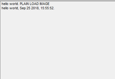

  • Experiment 2: Plain Load Image
       Demo code: Hello world (From the SDK), modifying the hello world code in below way.
PRINTF("hello world. PLAIN LOAD IMAGE \r\n");
PRINTF("hello world, %s, %s.\r\n", __DATE__, __TIME__);‍‍‍‍‍‍‍‍‍‍‍

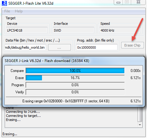

     Download image to external flash:
       1. Build the demo to generate a bin file.
          This plainload example linked the vector table to 0x00000000, but program to external flash 0x10000000.
       2. Program the bin file to external on board flash via SEGGER J-FLASH Lite(V6.22 or higher):
            a. Open SEGGER J-FLASH Lite, select device LPC54018.

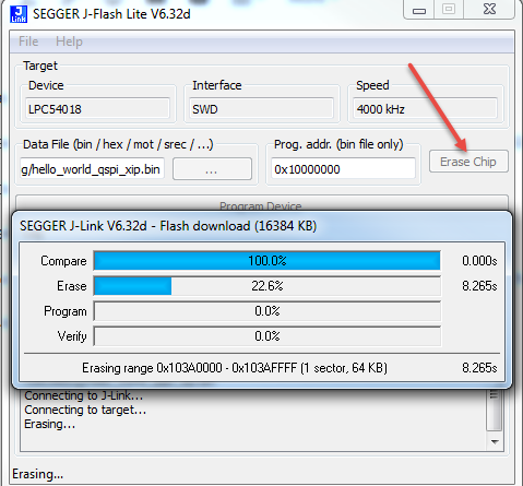

            b. Click the 'Erase Chip' to erase the extrenal flash.(if can not success, press SW4 button and reset the board, and try to erase again)
                Note: if can not success( press SW4 and reset the board, and try to erase again)
Fig4 Erase the external flash

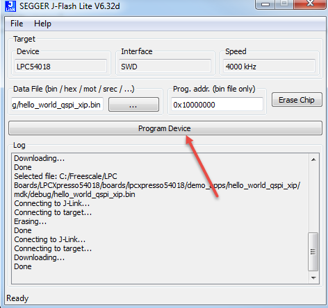

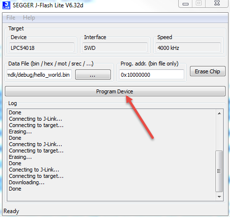

             c. Select the bin data file, set the '.bin/Erase Start' address to 0x10000000, then click 'Program Device'
Fig5 Program the external flash
Running testing:
Fig6 illustrates the result of  running the plain load image.
Fig6 Plain load image runing testing

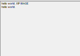

  • Experiment 3: XIP Image
       Demo code: Hello world qspi_xip (From the SDK), modifying the code in below way.
PRINTF("hello world, %s, %s.\r\n", __DATE__, __TIME__);‍‍‍‍‍‍‍‍‍‍‍‍
Fig7 Erase the external flash
Fig8 Program the external flash
     Running testing:
     Fig9 illustrates the result of  running the plain load image.
Fig9 XIP image runing testing
