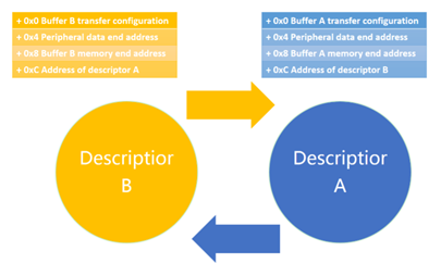

Overview
         Ping-pong is a special case of a linked transfer which typically used more frequently than more complicated versions of linked transfers.
A ping-pong transfer usually uses at least two buffers. At any one time, one buffer is being loaded or unloaded by DMA operations. The other buffers have the opposite operation being handled by software, readying the buffer for use when the buffer currently being used by the DMA controller is full or empty. The Fig 1 illustrates an example of descriptors for ping-pong from a peripheral to two buffers in memory.
Fig 1
Implementation detail

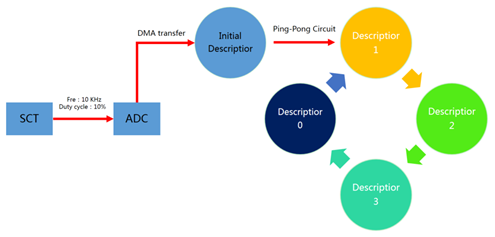

        To continuous transfer the converted result of the ADC to RAM, I’m going to use four 4 DMA descriptors to work in Ping-Pong mode to
achieve this goal as the Fig 2 shows.
Fig 2 Data flow via Ping-Pong mode

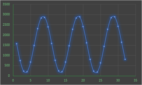

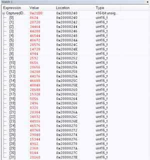

 Verification
  1.      Building the project, then click the  pastedImage_25.pngto debug;
  2.        Generate the sine wave: 1 KHz, 幅度:0~2 V,feed the wave the ADC via the J9_1(P0_30-ADC1);
  3.         Setting the breakpoint (Fig 4) to observe the ADC converted value CapturedData[32];
Fig 4
                       4. To verifying the result, I collect several group of data and use the Excel to make these data graphical for checking. Fig 6 is an example.
Fig 5
Fig 6
Fig 7
Fig 8
