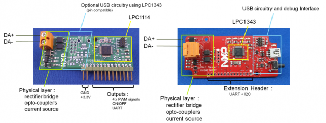

The DALI slave (AN11174 with OM13026 board) and the USB to DALI master (AN11175 with OM13046 board) can be used in combination with the Windows 7 PC GUI to create a demonstration and evaluation setup as described in UM10553.
The SDK contains the example software, DALI library, a hardware description and design files of both boards, documentation and is available for download at the end of this document.
DALI Slave OM13026                                                       DALI Master OM13046

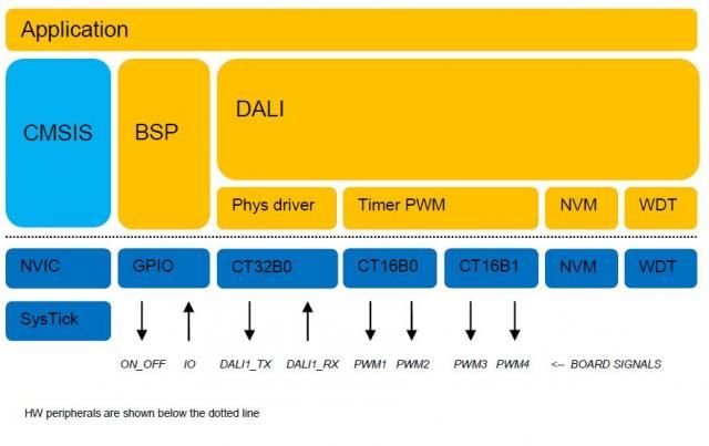

System notes
Controller side:
  • The LPC1100XL (up to 50 MHz - 45 DMIPS) offers enough performance to integrate DALI message coding/decoding and PWM generation in a single chip
  • Industry-leading low active power consumption of 110 uA/MHz for bus-powered devices
  • Storage of scene settings in non-volatile memory using EEPROM emulation in flash, or integrated EEPROM in LPC11E00 series
  • Up to four 16-bit and 32-bit timers, generating up to 11 PWM signals to control and dim the ballast
  • Reduced development complexity - software can be written in C
  • Reduced bill of materials - significant cost savings through Cortex-M0 architecture, plus many built-in peripherals to interface with lighting drivers and network in LPC1100XL

DALI Slave Implementation example (OM13026 board):
  • Contains isolated physical layer for the DALI bus with a Cortex M0 LPC111x microcontroller for the DALI protocol handling, and many I/O functions to steer external lighting drivers for solid state or compact fluorescent lighting applications
  • Schematics, gerbers and BOM also available to speed up development
  • Up to four PWM signals available to independently drive different lighting units
  • Frequency and resolution of the signals is software programmable
  • ON_OFF signal can be used independently from the PWM signals to switch a lighting driver into an OFF or ON state
  • I2C-bus pins can be used to externally connect other devices like EEPROM or a temperature sensor
  • Analog A/D input is available via pin 8
  • IO signal is left open for the end user
  • UART, I2C and A/D converter functionality not included in the software release
