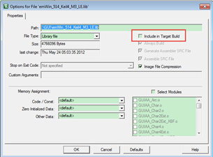

Then add this new lib to the KEIL project’s GUI folder like this:

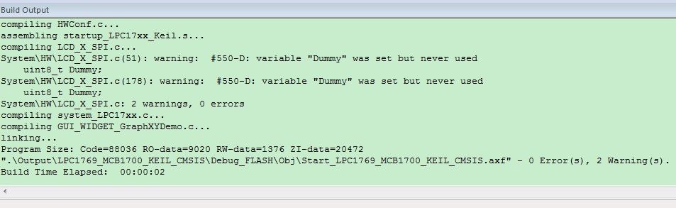

   After the emWin_M3.lib is added, remove the build of old lib emWin_514_Keil4_M3_LE.lib, just deselect item include in Target build in the right click options like this:
Save and rebuild it again, you will find the error is disappeared.

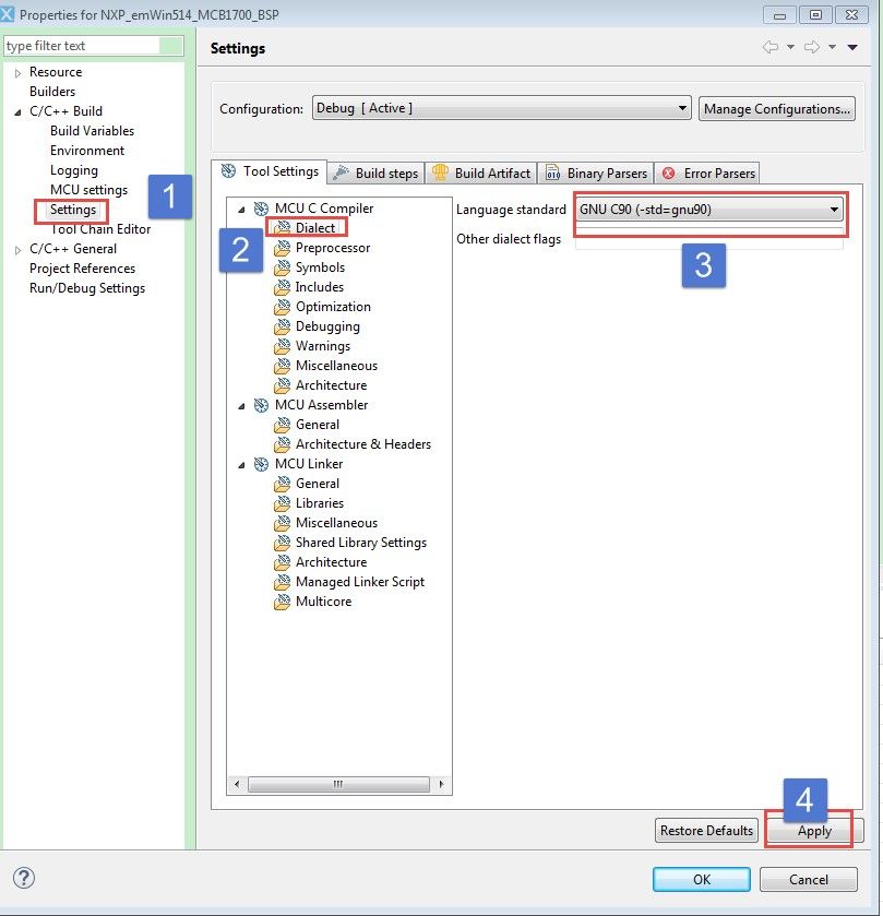

2.2.2 LPCXpresso project problem solution

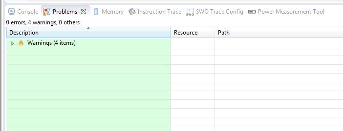

    Choose project->properties, change the language standard to GNU C90 stand like this:
  Click button “ Apply”,  then rebuild it again, you will find the error is disappeared:
Of course, you also can change the lib to the newest one, just like the method in the KEIL project, use the newest LPCXpresso emWin lib from this folder:  NXP_emWin530\emWin_library\LPCXpresso\libemWin_M3.a

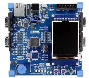

      After the build problem is solved, customer can download the code to the MCB1700 board by debugger or programmer, no matter with LPC1758, LPC1768 or LPC1769. After testing some MCB1700 boards, we found some board always display white, the emwin function doesn’t work, but some board can display the correct picture. All these boards seems the same.
      I have compared these boards carefully, I found the series number in the LCD have difference, now I list it as follows:
MCB
LCD Series number
RESULT
MCB1758
A774A-43-P101210-4072
OK
MCB1758
A774A-61-P120814-4074
Abnormal, LCD display white
MCB1769
A774A-22-P120814-4074
MCB1769
A774A-57-P120814-4074
     From the above form, we can find all the MCB boards which can’t work have one feature: the LCD series number contains P120814, so it should be related to the LCD controller, but what the controller on these MCB1700 boards? After download the LCD_Blinky code from the KEIL IDE install path:
C:\Keil_v5\ARM\Boards\Keil\MCB1700\LCD_Blinky
I found this project can display the picture correctly, so I do the debugging and the source code checking, after that I get the LCD with P120814 is using the HX8347-D LCD controller which from Himax company. But the LCD diver code in emWin MCB1700 BSP is for SPFD5408 LCD controller.

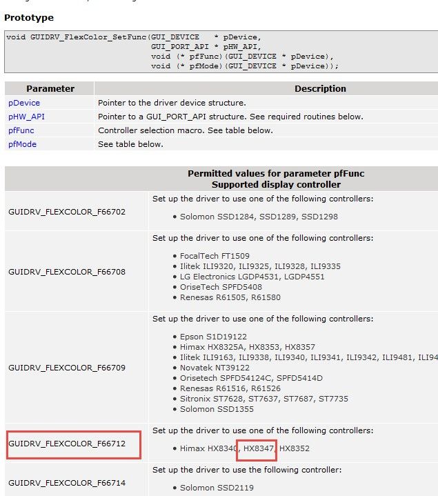

2.3.2.3 Modify the LCD_X_Config configuration
   From the emWin display drivers website in the Segger:
https://www.segger.com/emwin-display-drivers.html
You can find the HX8347 display driver is GUIDRV_FlexColor, the parameter pfFunc in function GUIDRV_FlexColor_SetFunc is GUIDRV_FLEXCOLOR_F66712.
  So, modify GUIDRV_FlexColor_SetFunc in the LCD_X_Config function like this:
GUIDRV_FlexColor_SetFunc(pDevice, &PortAPI, GUIDRV_FLEXCOLOR_F66712, GUIDRV_FLEXCOLOR_M16C0B16);

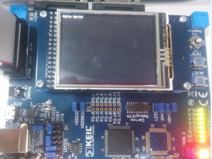

    After the modification, then save and rebuild it. At last, download the code to the MCB1700 board which was not working before, download the code to the board, press the RESET button on the board, you will find the LCD displays the GRAPH_DATA_XY demo picture like this:

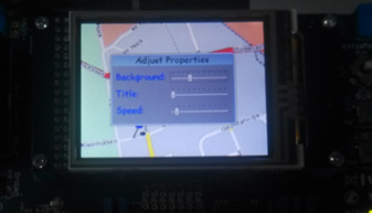

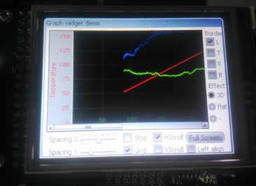

   After the above code modification for the not working MCB1700 board, if you have interest, you also can try the other application to display other pictures. In folder  NXP_emWin514_MCB1700_BSP\Application, there still has a lot of other applications, you just need to add it to the application folder in the project, then the LCD can display the according picture,  now list some application’s testing result.

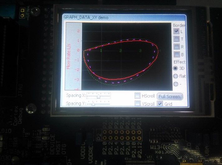

2.3.3.1 GUI_WIDGET_GraphYtDemo.c
2.3.3.2 GUI_HelloWorld.c
2.3.3.3 GUI_ALPHA_TransparentDialogDemo.c

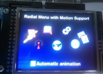

2.3.3.4 WM_RadialMenu.c
