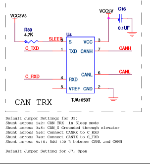

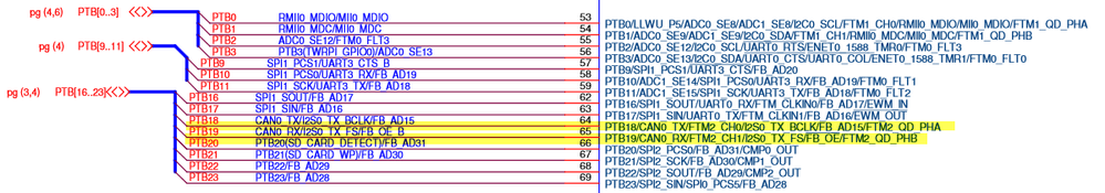

Hi Rishi,
please take a look at example for FlexCAN, the project is located under
<SDK_Install>/examples/<board>/driver_examples/flexcan/<use-case>/<toolchain>
there are two examples - FlexCAN Loopback and FlexCAN Network and because these examples are done for TWR-K64F120M, TWR-K60D100M, TWR-K65F180M, TWR-K21F120M and TWR-KV11Z75M, is needed to do some modifications for your board.
In case of FRDM-K64F, please connect TJA1050 according to TWR-SER Schematic to PTB18 and PTB19 and it should works.
More description for each flexcan functions you can get in fsl_flexcan_driver.h, located under C:\Freescale\KSDK_1.3.0\platform\drivers\inc
