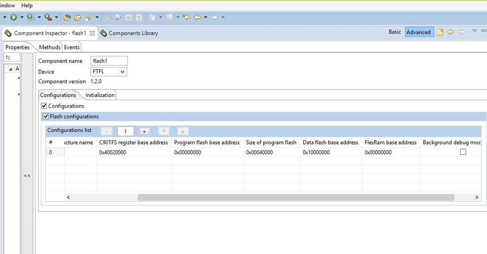

Change the flash configuration of CPU
Add fsl_flash component from PEx
The C90TFS base address is 0x40020000 Program flash address: 0x00000000.

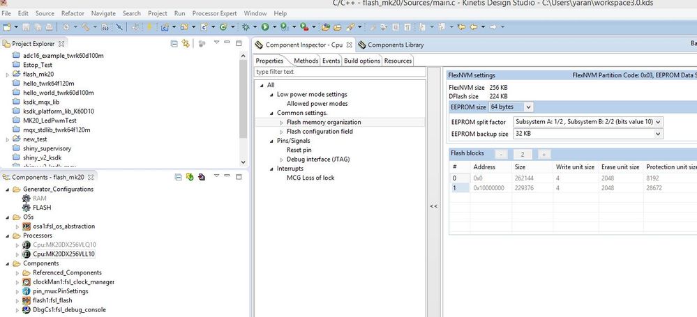

I found out at generated flash file, EEPROM and Dflash size is 0. I coudnt modify it.
I used the code below to try to write four bytes data into Dflash whose address is 0x10000000
It doesnt throw me error but i just couldnt read it back.
Could anyone spot anything wrong?

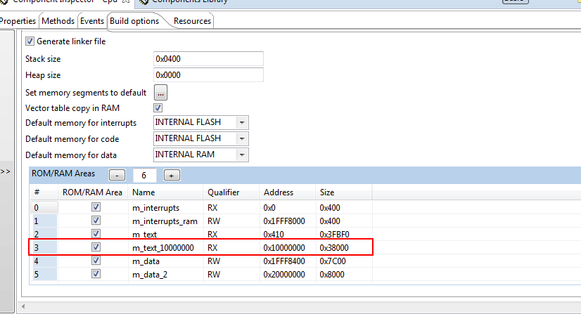

1. By default , the linker file do not include the FlexNVM memory define, so we need configure it by hand.
I see you have add it in the PE , please enable it :
2.  Before program flash memory , please first erase it .

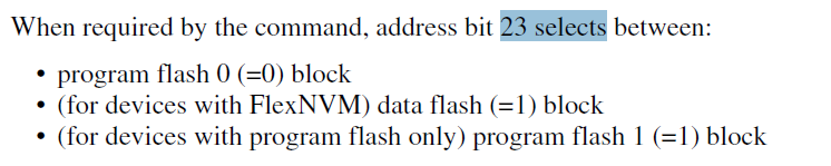

3. Please configure the 23 bit of  flexNVM address you wan to operate to 1, you can see the information on the Reference manual :
page 649 ->
