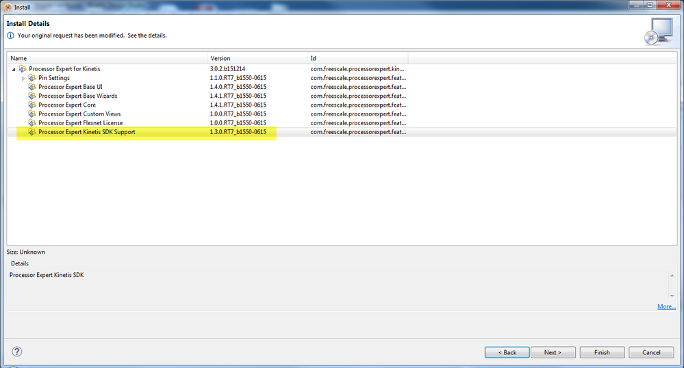

Thanks for providing info. about KSDK 1.3.0 .I downloaded it and now making project for same.As per steps given in  Getting Started with Kinetis SDK (KSDK) v.1.3.0  I used option "Install New Software" from Help menu of Kinetis Design Studio. After selecting Eclipse update.zip folder from
Archive button my installation stops due to missing requirement of Processorexpert1.3.0. Please can anyone tell me where I would get processoeexpert 1.3.0?
I got Processorexpert 3.0.0 on site. I would also like to know where should I place processor expert folder.

Hi Patil,
I suggest you online install "processor expert for kinetis 3.0.2" install package, which includes processor expert kinetis SDK support v1.3.0.
see attached video.
can this help you?
