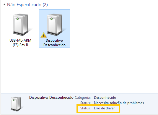

I tried to use the "fsl_usb descriptors" to generate the "usb_descriptor.c/.h" archives and can't initializate the components. I think it's a bug from PEx!?
Finally, it doesn't work. My Windows show a message like: "unknown device" or "driver error". The image below shows it (sorry portuguese):
I updated the driver from the "virtual_com" example ".inf" for FRDM-KL27Z, and it doesn't work.

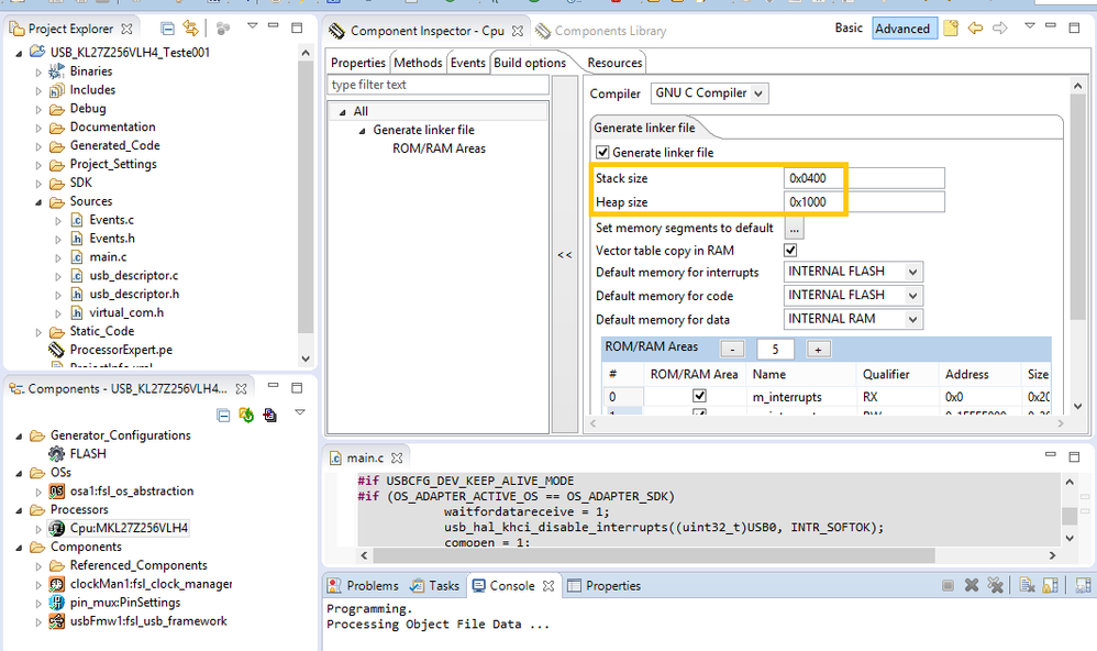

Check Set Build Options
Stack Size 0x1000
Heap Size 0x0400

Temporarily give up mode CDC, check in the other mode are supported PE , for example HID.
Stack Size 0x1000
Heap Size 0x0400

I tried to change the configurations like you sad. But doens't work again.
It's funny because I tried contrary what you said, and it works.
The configuration that I used is shown below:

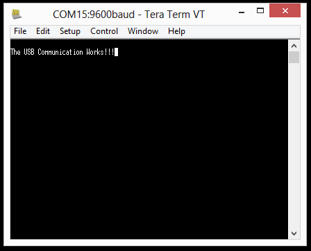

The driver was recongnized, and the communication is ok!
A test is shown below:
