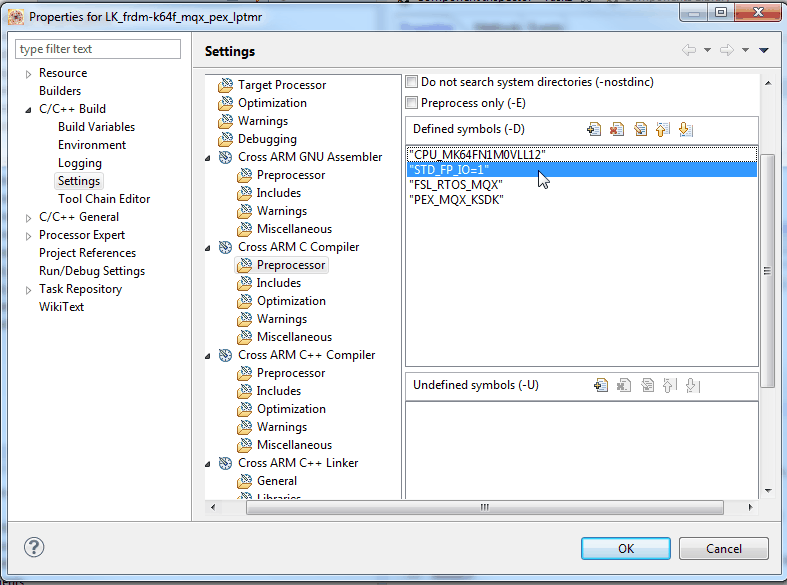

DavidS
Hi Matthias,
I have reproduced your finding and have submitted a trouble ticket to our MQX KSDK team.
Documentation should be updated and we should have a master location to define the STD_FP_IO option/capability.
My workaround...
Change std_prv.h to following:
#ifndef STD_FP_IO//DES added #ifndef
#define STD_FP_IO 0
#endif
And in the project Properties...add Defined for "STD_FP_IO=1":
David

DavidS
Hi Matthias,
My workaround...
#define STD_FP_IO 0
#endif
David

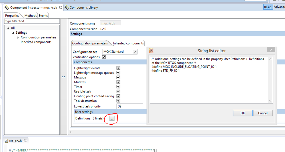

rogerchaplin
Just thought I'd add my $0.02 worth for anybody else in this situation. I'm using KSDK 1.2.0 with Processor Expert in KDS 3.0 to create code to be built with IAR Embedded Workbench. I've added the MQX component to my project and chosen the standard MQX instead of MQX Lite. I found that the right place to put the define for STD_FP_IO = 1 is in the Component Inspector for MQX, in the User settings Definitions dialog:
Also be sure to make the change to std_prv.h in the KDS project. If you change any of the generated files outside the Processor Expert environment (i.e. you edit them in IAR Workbench) you'll get errors from Processor Expert the next time you try to generate code.
