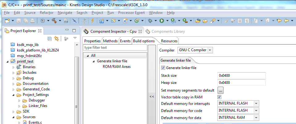

DavidS
Hi Audi,
Found fix but need to try to understand why.
Please set heap to 0x400.
Generate Code.
Do a project clean and rebuild.
David

audi_mcavoy
Thanks David, that worked for me too.
