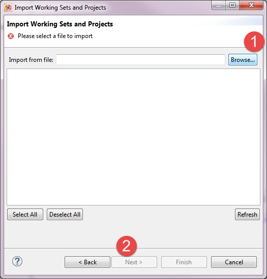

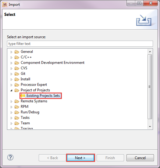

Hi Ole Asbjorn Fadum,
more easy way then import project manually with all libraries is work with .wsd file.
Each demo application in MQX RTOS for KSDK has one workspace file that contains all the required library project files and the application project itself.
<install_dir>/rtos/mqx/mqx/examples/<demo_name>/build/kds/<demo_name>_<board_name>/<demo_name>_<board_name>.wsd
So, e.g.
  • go to KDS 3.0., File -> Import -> Project of Projects -> Existing Projects Sets
  • Browse .wsd file
  • Choose example and its .wsd file, e.g. lwlog example for FRDM-K64F
  • In structure is project with required libraries
After that you can just Build all in KDS or Build Selected in Build Configurations.
