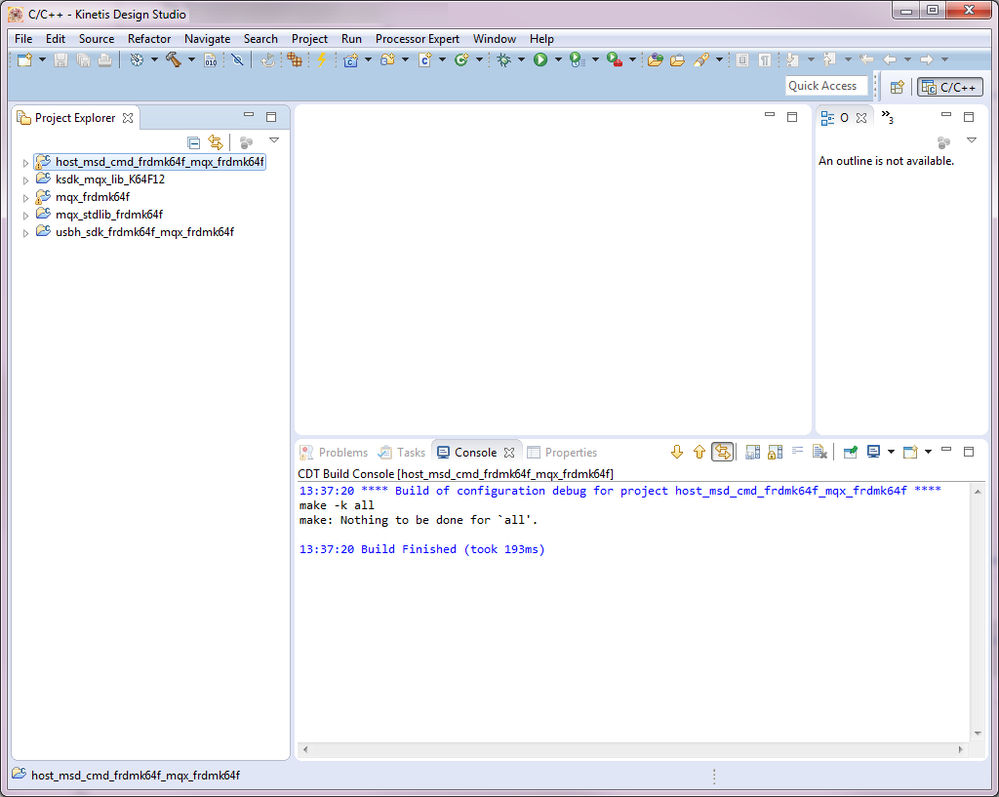

ivadorazinova
Hi Ole Asbjorn Fadum,
I tested whole procedure on my side and it was compiled without problems on my side.
First I imported the project, then I imported the libraries.

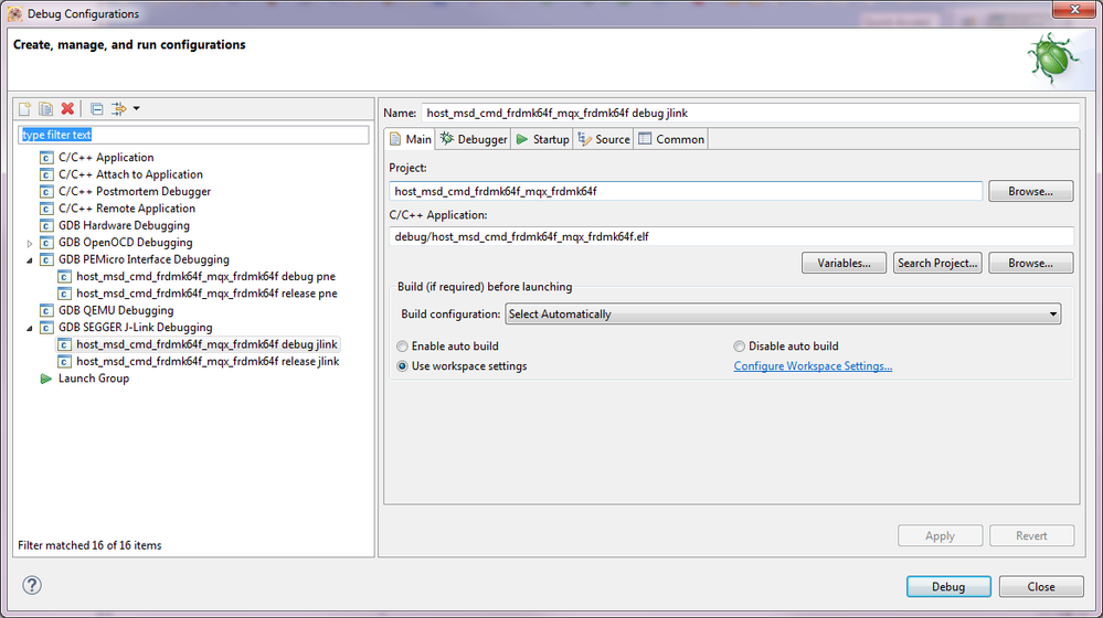

When I go to J-link Debug mode, K64F is set.
Do you have the same screen for Debug Configurations?
Please, describe your problem more detail.
