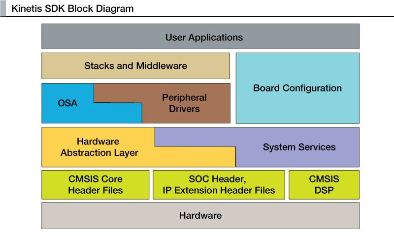

KSDK package contains set of peripheral drivers. You can find these drivers under C:\Freescale\KSDK_1.3.0\platform\drivers
KSDK consists of the following runtime software components:
You can test these drivers under concrete board, in case of FRDM-K64F C:\Freescale\KSDK_1.3.0\examples\frdmk64f\driver_examples
or develop your own code based on the demo using KSDK Project Generator Tool​ (for creating KSDK projects or cloning KSDK projects/demos)
New Kinetis SDK Project Generator is available!
For more information about all these drivers please refer to KSDK v.1.3 API Reference Manual

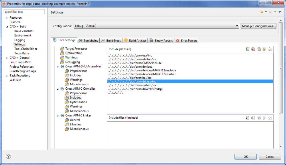

Hello Iva,
I have FRDM-K64F board running myproject with LED flashing. What I would like to do is to add SPI driver to myproject.
I Have tried DSPI Demo on its own on FRDM-K64F  that works ok.
Thank you for your help.
Baldev
2,896 Views
ivadorazinova
Hello baldev patel,
just include the driver to your project and to compiler settings.
I mean include e.g. #include "fsl_edma_driver.h" in main.c
and have included correct files and paths in compiler settings:
Some useful tips for you:
