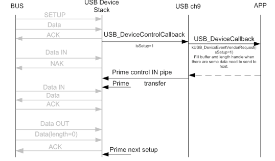

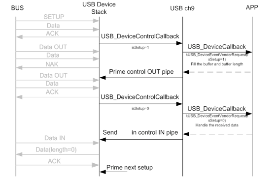

Hi Ryan:
The vendor request setup packet is handled at line815(with setup OUT data stage and setup flag is set) and line853(with setup IN data stage and setup flag is set) in function  USB_DeviceControlCallback of file usb_device_ch9.c. For setup OUT data stage, after the data is received, the data is handled at line902(setup flag is clear and the data buffer is saved in controlRequest.buffer) in function  USB_DeviceControlCallback of file usb_device_ch9.c.
The following is the vendor request with setup OUT data stage work flow
The following is the vendor request with setup IN data stage work flow:
