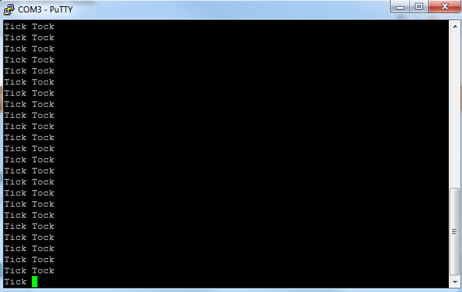

Hello Audi,
Please insert your SD card into your board.
I have test your project on my side after i insert one SD card, it can work well , please see the  result :
Hope it helps
Alice

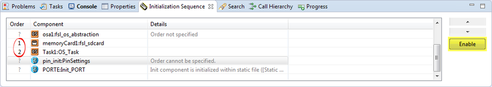

That result is because the SD Card initialization is not finished by the time the task is first launched. If you print the values again then you might receive the expected results.
To make sure that the SD card is initialized before your task is executed, you can change the initialization sequence.
Go to Window -> Show View -> Other...-> Processor Expert -> Initialization Sequence. Enable the initialization for the fsl_sdcard and the OS_Task components and make sure that the SD card is initialized first:
Then the correct information will be printed:
Regards!
Jorge Gonzalez
