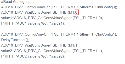

task1()
while(1)
  //Read Analog Inputs
  ADC16_DRV_ConfigConvChn(FSL_THERM1,1,&therm1_ChnConfig0);
  ADC16_DRV_WaitConvDone(FSL_THERM1,0);
  value1=ADC16_DRV_GetConvValueSigned(FSL_THERM1,0);
  PRINTF("ADC1 value is %d\n",value1);
  ADC16_DRV_ConfigConvChn(FSL_THERM1,1,&therm1_ChnConfig1);
  DelayFunction ();
  ADC16_DRV_WaitConvDone(FSL_THERM1,1);
  value2=ADC16_DRV_GetConvValueSigned(FSL_THERM1,1);
  PRINTF("ADC2 value is %d\n",value2);
  ADC16_DRV_ConfigConvChn(FSL_UNIVERSAL,1,&universal_ChnConfig0);
  ADC16_DRV_WaitConvDone(FSL_UNIVERSAL,0);
  value3=ADC16_DRV_GetConvValueSigned(FSL_UNIVERSAL,0);
  PRINTF("ADC3 value is %d\n",value3);
  ADC16_DRV_ConfigConvChn(FSL_UNIVERSAL,1,&universal_ChnConfig1);
  DelayFunction ();
  ADC16_DRV_WaitConvDone(FSL_UNIVERSAL,1);
  value4=ADC16_DRV_GetConvValueSigned(FSL_UNIVERSAL,1);
  PRINTF("ADC4 value is %d\n",value4);

Hello RAHUL,
Here :
the parameter of "uint32_tchnGroup " , i think is 1 , for in the ADC16_DRV_ConfigConvChn function , you have choose "1" .
It is the same about ADC1 .
Hope it helps
Alice

rahul_eris
Thanks Alice_Yang
while resetting the parameters passed, its worked for me.
I think parameter of "uint32_tchnGroup" is same for all channels in one module
Parameter value will change for the next adc module.
while(1)
   ADC16_DRV_ConfigConvChn(FSL_ADC1,0,&adc1_ChnConfig0);
   value=ADC16_DRV_GetConvValueRAW(FSL_ADC1,0);
   printf("value=%d",value);
   ADC16_DRV_ConfigConvChn(FSL_ADC1,0,&adc1_ChnConfig1);
   value2=ADC16_DRV_GetConvValueRAW(FSL_ADC1,0);
   printf("value=%d",value2);
   ADC16_DRV_ConfigConvChn(FSL_ADC2,0,&adc2_ChnConfig0);
   value3=ADC16_DRV_GetConvValueRAW(FSL_ADC2,0);
   printf("value=%d",value3);
   ADC16_DRV_ConfigConvChn(FSL_ADC2,0,&adc2_ChnConfig1);
   value4=ADC16_DRV_GetConvValueRAW(FSL_ADC2,0);
   printf("value=%d",value4);
It worked for me now...Not sure whether it may misbehave in future......
