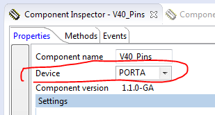

Using PE, it seems I should add one copy of fsl_gpio for each port I want to use.  In fact, the tabs view of the Component Inspector has a drop-down list where I can pick a port.
But, it doesn't seem to work this way.  Adding a second fsl_gpio component causes errors (which seems to be directly related to the Device selection).
Turning off the tabs view doesn't help -- it just hides the Device option.
So for right now, I have all of my GPIO configured in one instance of fsl_gpio.  It can be a little awkward, the pins are scattered around multiple ports.  Some of the pins are accessed individually.  Some are accessed in groups.
Is this the best approach?  Is there a better way?
How are you handling your GPIO?

Hello Audi McAvoy:
Short answer: You only need one fsl_gpio component.
The drop down list should not be there, this will be fixed, we are sorry about this. For a detailed discussion check the next thread:
Re: GPIO in PEx is so bizarre...
And also a very short video I posted:

I think the pull down shouldn't be there and as you have found it doesn't affect the code.
Will check to see if fixed for next revision.
