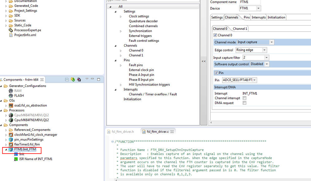

Hello Shaul,
Up to now , under the KSDK component of "fsl_ftm" can not configure the capture ,
only can use the method to configure by yourself.
While you can use the component of "Init_FTM" under KSDK project :
Hope it helps
Alice

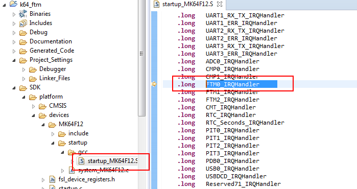

When I provide ISR Name using Init_FTM KSDK generates ISR warning .
1. My guess is that ISR name is wrong , but what is a legal name
2. I understand that using your solution I will have to write my own ISR using direct access to F64 "ftm and gpio" registers, is it correct.
3. Do you know any other alternative that saves digging K64 reference manual
Shaul
6,407 Views
Hello Shaul,
1. In the KSDK project, the ftm0 interrupt name is FTM0_IRQHandler :
So if you want use the ksdk in your project, please use this interrupt name.

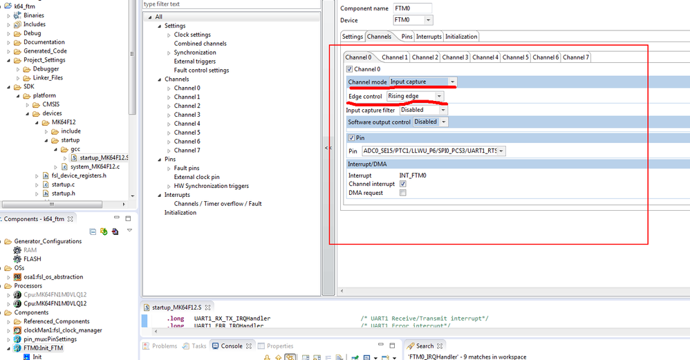

2. You also can directly configure the PE component on the KSDK :
