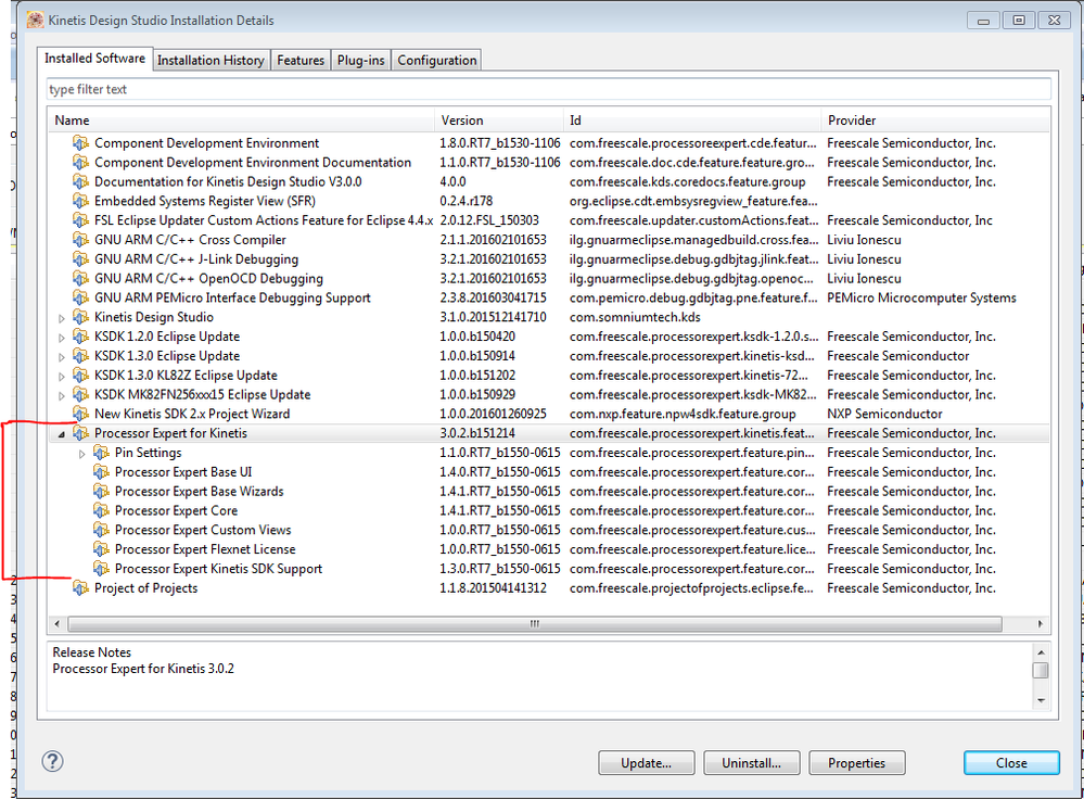

I am using a TWR-KV46F150M board.  I have Knietis SDK v.1.3.0_KV4xF_1.0.0 installed.  I would like to use the driver fsl_flexcan Peripheral Driver.  I added it to the Components, everything looks filled out.  I am not sure where the setup is done.  I am assuming the application will have to call some functions.
The problem is when I try to generate the code, I get the following message
ERROR: Not possible to run: Drivers\Kinetis\printConfigs.js. javax.script.ScriptException: sun.org.mozilla.javascript.internal.EcmaError: TypeError: Cannot find function getEditorData in object com.processorexpert.core.service.api.internal.PExInspectorIntegerItemAPI@680703. (<Unknown source>#89) in <Unknown source> at line number 89
Any ideas what I am missing?

Hi Robert Heldibridle
What version of IDE do you have? I'm using KDS 3.2 and processor expert 3.0.2 and I don't see this problem.
Also, what OS do you have?

robertheldibrid
I upgraded Processor Expert and now it works.  I think I had version 3.0.0.  Thanks for your help.

This is from the help...
  KSDK 1.3.0 KV4xF Eclipse Update1.0.0.b151015com.freescale.processorexpert.kinetis-168mhz-kv4xf.sp.feature.groupFreescale Semiconductor, Inc.
    Processor Expert Kinetis SDK Support1.2.0.RT7_b1515-0427com.freescale.processorexpert.feature.core.kpsdk.feature.groupFreescale Semiconductor, Inc.
  Processor Expert for Kinetis3.0.0.RT7_b1515-0427com.freescale.processorexpert.kinetis.feature.feature.groupFreescale Semiconductor, Inc.
    Pin Settings1.1.0.RT7_b1515-0427com.freescale.processorexpert.feature.pinsettings.feature.groupFreescale Semiconductor, Inc.
    Processor Expert Base UI1.4.0.RT7_b1515-0427com.freescale.processorexpert.feature.core.ui.feature.groupFreescale Semiconductor, Inc.
    Processor Expert Base Wizards1.4.0.RT7_b1515-0427com.freescale.processorexpert.feature.core.wizards.feature.groupFreescale Semiconductor, Inc.
    Processor Expert Core1.4.0.RT7_b1515-0427com.freescale.processorexpert.feature.core.feature.groupFreescale Semiconductor, Inc.
    Processor Expert Custom Views1.0.0.RT7_b1515-0427com.freescale.processorexpert.feature.custom.mcu.feature.groupFreescale Semiconductor, Inc.
    Processor Expert Flexnet License1.0.0.RT7_b1515-0427com.freescale.processorexpert.feature.license.feature.groupFreescale Semiconductor, Inc.
I think I have everything.

jorge_a_vazquez
I'm working in your issue, Did you install the eclipse update for KSDK 1.3.0 KV4xF ? Could you please check the installation details and tell us if you can see KSDK 1.3.0 KV46xF Eclipse Update and processor Expert for kinetis?
I've created the project based on your description and I do not see any problem with code generation.
