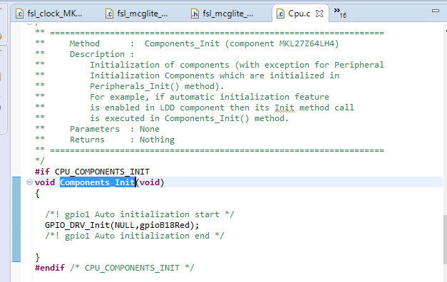

I also found another reference for flashing leds
Freescale Freedom development platform: [FRDM-K... | element1

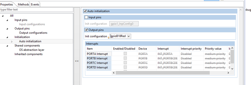

However, it seems when multiple fsl_gpio are declared.
only one fsl_gpio can be initialized.
On the Auto Initilization it seems only one port can be initialized on the menus
and indeed in Cpu.c: Components_init(void) only has one bit initialized

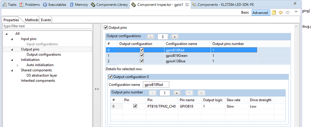

Hi Neil,
Actually you declared 3 "Output configurations". Instead you should declare 3 "Output pins" for the same Output configuration. Give a second check to the tutorial you linked and you will see the diference.
If you have more questions please open a new thread, to keep this post Non-PE related.
