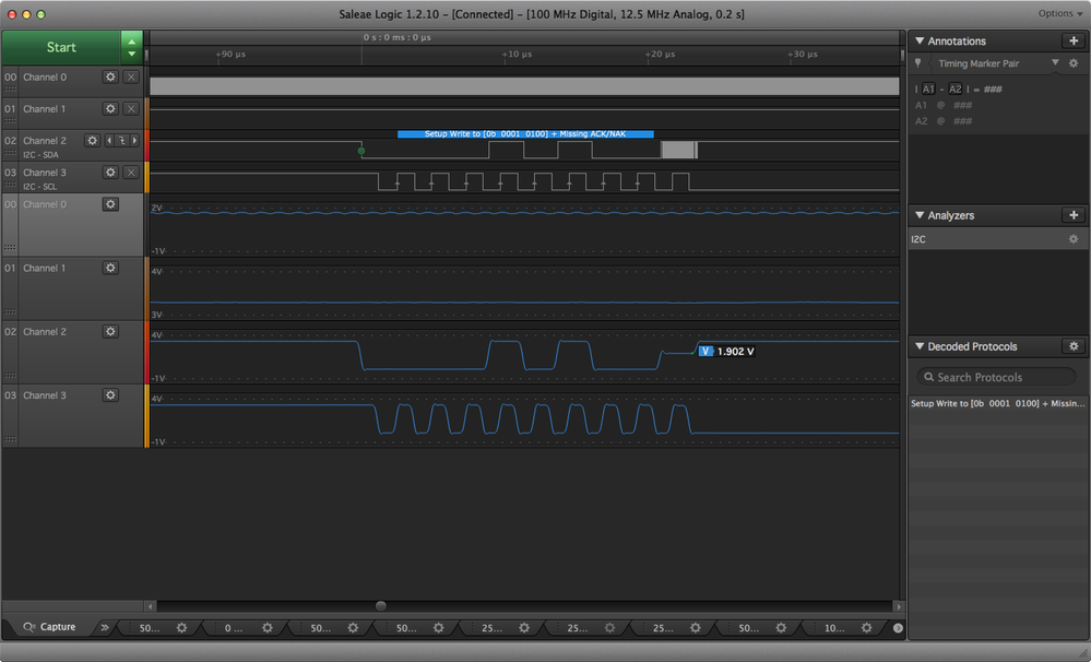

I have a FRDM-K22F wired to a Teensy Audio Shield which is essentially an SGTL5000.
Whenever I attempt an I2C write I get a strange result - instead of getting an ACK I get a NACK. Checking with a logic analyser I can see that the I2C SDA line is pulled down only halfway. See the attached screenshot showing the analog output of Channel 2 which is I2C SDA - the problem point is marked at 1.902 V. What could be causing this strange behaviour?
I'm pretty sure it has to do with my K22F board configuration - perhaps I need to disable a pull up resistor somewhere?

michael_galda
No, if you see the MCLK clock output, you are OK.
Regarding the I2C signal levels.
What i2C port/pins are used, are there external pull-ups used?. Is the Port PCR set to Open Drain mode?

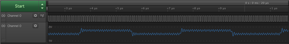

donturner
Thanks Michael. You might be on to something there. I am generating a MCLK signal at 12.288MHz but the analog output looks strange:
See how it alternates between 2 ranges: 1.38V-1.62V and 1.63V-1.89V.  I wonder if that could cause the SGTL5000 to behave erratically.
Here's the code I'm using to generate MCLK:

michael_galda

donturner
"Is the Port PCR set to Open Drain mode?" I don't think so, and I think this is the problem.

donturner
It's working now. Here's the full code I used (I'm using KSDK 2.0 so some functions had to be updated):

michael_galda
OK, thanks for that update. / welcome!
To your question, why the I2C slave device (SGTL) is unable to pull the line low to 0V is easy answer:
- Where the pin is in normal (push-pull) configuration, It actively drives both 1/0 on the output, so if there is a log.1 on the pin output, there is a strong 3V3 signal driven - so the external device is unable to pull it down, and two outputs are fighting resulting to the middle levels.
In the Open drain mode, only 0 is actively driven onto the output, while the 1 (3V3) is managed by external pull-up, which represents very weak signal, which can be pulled low easily by the external device.
So this is it.
