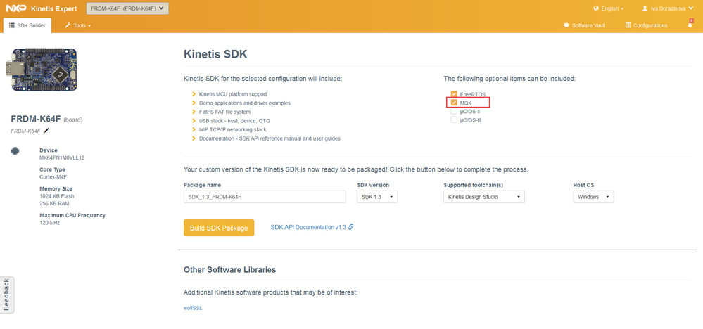

ivadorazinova
Hi Tom.
It depends, what option you choose in Kinetis Expert.
If you want to work with Shell, you must choose MQX option
after that you will see under middleware rtcs folder:
You can find Shell example under <KSDK1.3_path>\middleware\tcpip\rtcs\examples\shell
The Readme to RTCS Shell Application you will find in the same folder.
Documentation for the Shell - MQX RTOS RTCS User's Guide (IPv4 and IPv6) you will find at <KSDK1.3_path>\doc\tcpip\mqx_rtcs
I hope this helps you.
In case of any issue, please let me know.
