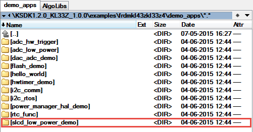

In the "Getting Started" user guide for KSDK 1.2 was described how to use the SLCD. But the KL43Z example directory contains no SLCD example. Have anyone an idea how I can use the LCD driver?

Hello Alexander Urban,
you are right that there is a mistake with the documentation and incomplete information.
In documentation there is path for FRDM-KL43Z <SDK_Install>/examples/<board>/driver_examples/slcd/<toolchain>
but in fact you must install Standalone Release for KL43Z and KL33Z, you can download it from https://freescale.flexnetoperations.com/control/frse/download?agree=Accept&element=6341397
and after installation, slcd demo appears at C:\Freescale\KSDK1.2.0_KL33Z_1.0.0\examples\frdmkl43zkl33z4\demo_apps\slcd_low_power_demo folder.
I hope it helps you,
Iva
