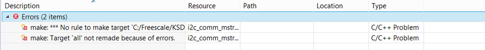

I just did what you said but while building it gives me 2 errors that are :
do you know what the problem is about?
5,980 Views

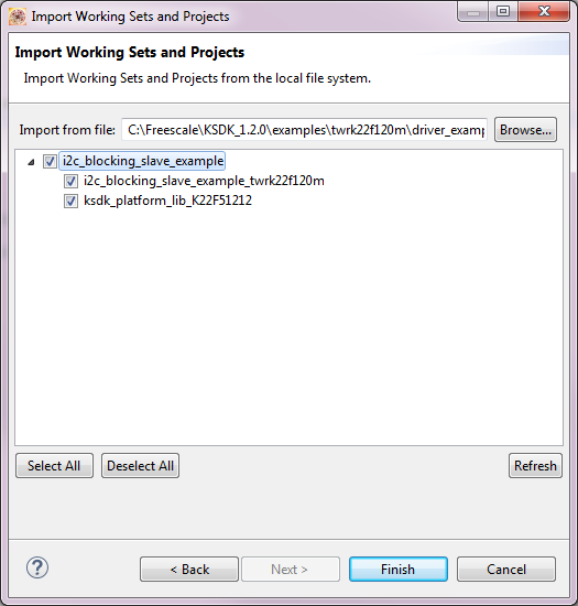

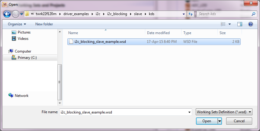

ivadorazinova
Hello Negar,
This error is caused by no build libraries.
But you can avoid these errors it by importing .wsd files.
Please, go to File -> Import in KDS
And now you see what you need for the libraries for this example
I hope this helps you,

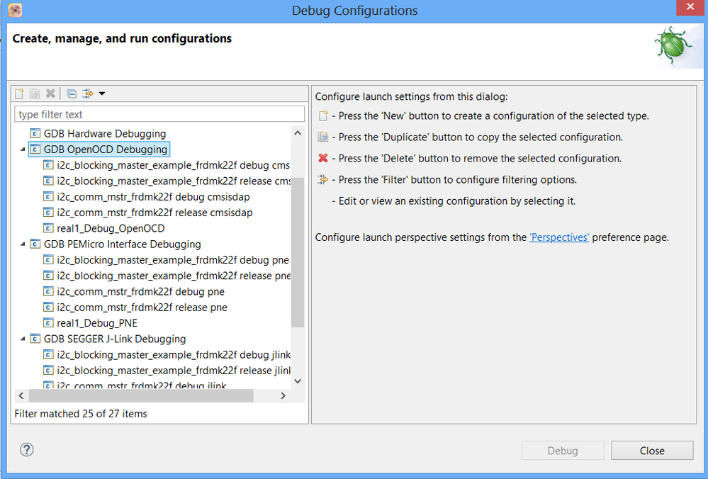

negarerfanian
Hello Iva,
Thank you so much it worked, but while debugging which one should I choose?
It still doesn't debug.
5,980 Views

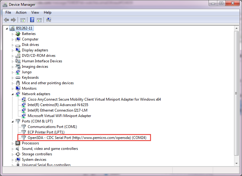

ivadorazinova
Hello Negar,
it depends, what you have.
Please, look at Device Manager:
And according to it, it is needed to set debug configuration.
Please, see
Video Link : 3283
Iva
