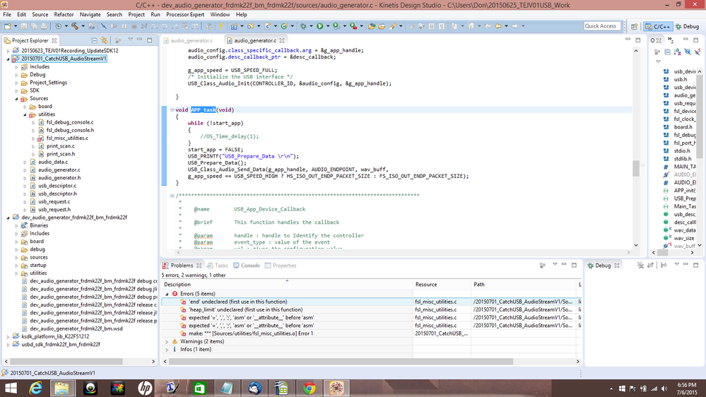

- So I built dev audio generator for k22F - put it on my custom built PCB / Device. It works.
- I copy the exact same files and structure into a new project - including fsl_misc_utilities.c, which causes build errors (Why is a mystery to me, since I have followed the USB application directions - in fact I'm almost exactly copying a project?)
- Leaving out fsl_misc_utilities.c allows it to compile and run, but crashes into default IRQ handler after post_init. The initialization process of the hardware is identical to the working function above that runs.
- What is missing? The only difference I can find are the compiler flags?

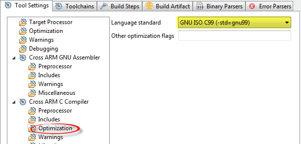

Now, in your particular case, I think the problem is that inline assembly instructions (asm) are not recognized, so try changing the compiler language to GNU ISO C99, like below picture:
Then the build errors should be solved.
Let me know if you have further issues.

So, problem #1 solved with fsl_misc_utilities. Thank you!
