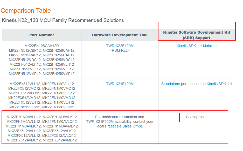

I have my driver which is already ported for MK22FN1M0VLH12 MCU for MQX-4.2. I want it to port for KSDK v1.2 with KDS 3.0 . I have referred Kinetis SDK v.1.2.0 Release documents, Here in this document in supported MCU list i am not finding my MCU name so i am in doubt that KSDK supports this MCU or not. Have anyone idea that KSDK supports MK22FN1M0VLH12 MCU or not.
Or Is there any alternate way to get support of KSDK for my MCU?

As so far , the KSDK1.2 doesn't support this chip  MK22FN1M0VLH12 ,
you can see on the website about h the information :
K22_120 |Kinetis K22 120 MHz MCUs|Freescale
Hope it helps

at the moment MK22FN1M0VLH12 is not supported by current KSDK.
But you can port it by yourself according to this document.
