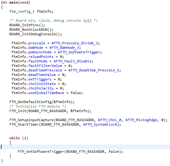

Hi Everyone,
Im new to using Kinetis microcontrollers and I have a TWR-K65F180M board that I'm trying to use to capture inputs from an encoder.  I am working off of the PWM_twochannel driver example using SDK2.0. I have the FTM set up to use FTM2_CH0.  The api document says that every time a rising edge is captured the counter value should be stored in the CnV register.  However, unable to read any values in the CnV registers using the EmbSysRegView.
Thanks for any help!
145529_145529.pngpastedImage_2.png145530_145530.pngpastedImage_3.png145531_145531.pngpastedImage_4.png

Hello Jake,
Sorry for late response. For input capture mode, you will need to set 0xFFFF to MOD register in order to use counter in free-running mode. Program should look like as follows:

If you try this code, you will be able to print on screen counter value.
I hope this can help you!

Thanks for the help.  I am still having some issues with the BOARD_FIRST_FTM_CHANNEL. Just to clarify I need to define BOARD_FIRST_FTM_CHANNEL as kFTM_Chnl_0 and BOARD_FTM_BASEADDR as FTM2 to capture input from FTM2_CH0 that will measure the time between riding edges and print this to the screen.
Thanks again
