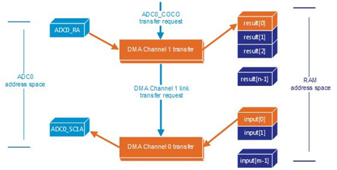

System overview
ADC Flexible Scan mode requires two DMA channels for one ADC converter. DMA channel 1 with a higher priority transfers the resultant ADC data from the ADC0_RA register to a memory buffer. DMA channel 0 with a lower priority transfers the next ADC channel setting (input multiplexer channel) from the constant buffer.
The following figure depicts the application
Figure 1. Depicts the application

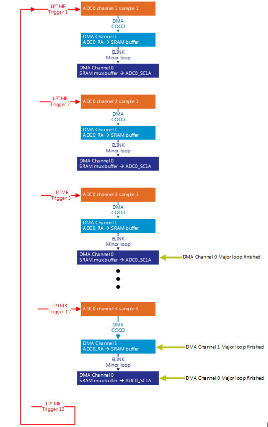

Flow diagram:
The example code that accompanies this application note demonstrates a continuous scan conversion from three ADC channels. Each channel is measured four times, so the result buffer size is 3 × 4 = 12 (the real buffer size is 16, to demonstrate that only 12 data field parts are written). The ADC works in hardware trigger mode, with the LPTMR timer serving as the trigger source. Scanning is executed in continuous mode; thus, after a major loop has finished, the result buffer pointer address_0 is reloaded and the conversion begins again from the start buffer address. To calculate and change the frequency, check the macro INPUT_SIGNAL_FREQ to change the frequency value in Hz. The DMA1 is triggered by the ADC, and the DMA0 is triggered by the eLINK of minor   loop of DMA1. In this example the frequency is set to10 Hz, and is the number of samples is 10.
Figure 2. Flow diagram

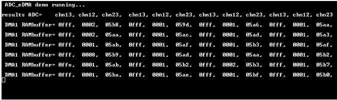

Open your terminal (baud rate 115200)

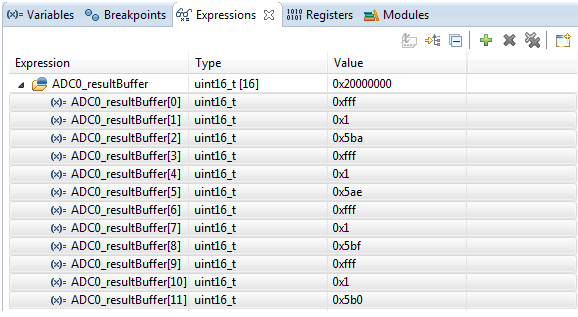

The results will appear on the terminal software.
Figure 3. Screen serial
You can also see the results in the debugger window.
Figure 4.  result buffer
