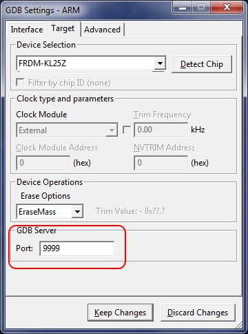

I have installed:-
USBDM_4_10_6_250a_Win  and  USBDM_Drivers_1_3_0_Win_x64  on Windows 7
Using 'ARM GDB Server' setup I can detect the MKE04Z804 processor OK  on my FRDM-KE04Z Dev PCB
But I get the following error on exit:-
Welcome to USBDM GDB server
ERROR: Could not create server at the specified port !
Please Help
1,505 Views
pgo
Senior Contributor V
Hi George,
The only time I have seen this error is when there is already a program using that port.
I assume you are experimenting with the stand-alone server launched from the Windows Start Menu.  Can you try changing the server port if you have not already tried this.
The only other suggestion is related to networking and firewalls.  Is it possible that the GDB server is not allowed to create sockets?
bye
1,505 Views
GeorgeChamberla
Thanks for the reply.
Changing the GDB Server Port number fixed it.  Thank you.
