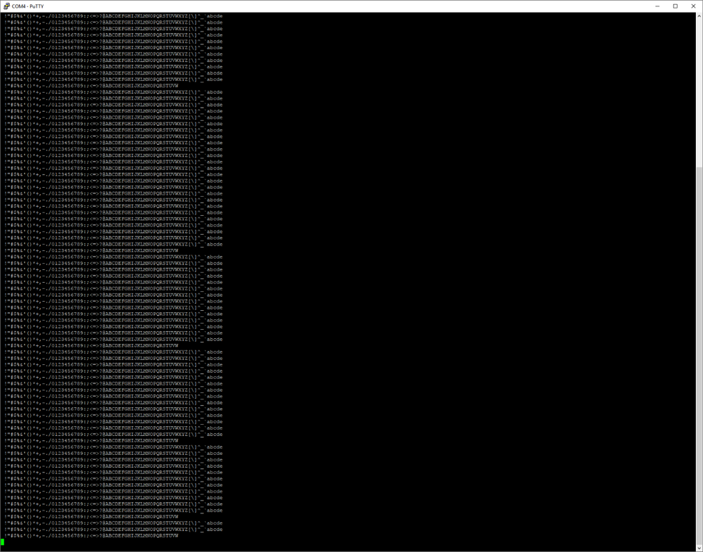

Hi everyone,
I'm having trouble making the vcom example work as expected.
I implemented the read/write blocking functions, but sending long data packets (chunked at 56-byte block consecutive transfer)
presents some problem.
Example Terminal output:
/* main example using freertos */
/* Init board hardware. */
BOARD_InitPins();
BOARD_BootClockRUN();
/*init the api usb*/
APPInit();
uint8_t buff[70];
int k = 32;
for(int i=0;i<sizeof(buff);i++){
buff[i] = k;
k++;
while(1) {
usb_write(buff,sizeof(buff),100);
usb_write("\n\r",2,100);
vTaskDelay( pdMS_TO_TICKS( 1000 ) );
I tried without and with hardware flow control, nothing changed.
I'm using the nxp driver located inside the folder usb_device_cdc_vcom.
OS windows 10
mcu MK21FN1M0xxx12
sdk version 2.3
Same problem under ubuntu (tail -f xxxx)

cristianpietrob
Thank you, Mark, in the end, it was a Qt bug + a problem with the USB driver.
I'm sharing the code the solve everyone else similar problem.
