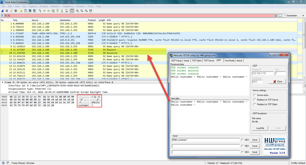

Hello SHANKAR ISLAVATH,
I apologize for my late response.
I tried whole procedure also with Hercules and Wireshark and all works.

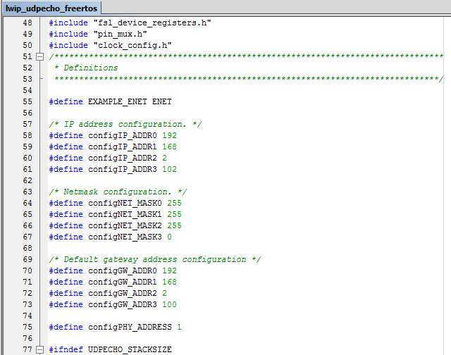

Please, are you sure that you correctly set IP Addresses ?
and
In Wireshark is also working without problems:

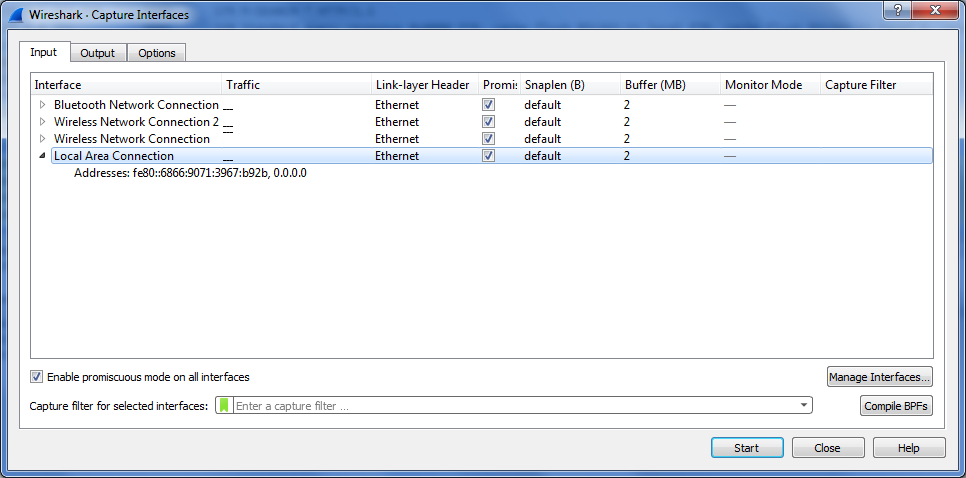

needs to be correctly set network card
