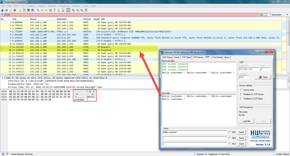

hi,
iam using the udp echo in k66 from sdk2.0 ,but when i run this code it runs fine but othing is appears in the wireshark .
标签 (1)
1 回复
1,446 次查看
ivadorazinova
Hello maheshwar reddy,
I apologize for my late response.
I tried on my side and it works without any problem.
Please see picture below:
Please, do you have correctly selected network card?
In my case I have LAN Connection:
In case that you have correctly set all settings and still does not work you,
please ask on Wireshark forum https://ask.wireshark.org/
Thank you.
