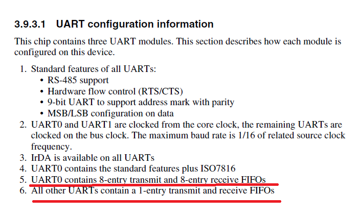

danielchen
Hi:
Sorry I lost tracking of this thread.
From the KV31 reference manual, only uart0 contains 8-entry receive FIFOs,  all other UARTs contains a 1-entry receive FIFOs.
Do you use uart0 or other?
