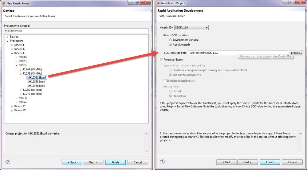

ivadorazinova
Hello James,
Please, check your options with my screenshot.
Iva
4,860 Views
Jorge_Gonzalez
Hello James Carter:
With "board configuration tab" do you mean from the New Project Wizard?
KSDK v1.2 does not come with direct support for TWR-KL25Z48M (example applications or board files), only for FRDM-KL25Z. Sorry for this inconvenience.
However the on-board MCU of TWR-KL25 is fully supported with KSDK v1.2, so in your case you can select the device "MKL25Z128xxx4" from KDS New Project Wizard.
Regards!
