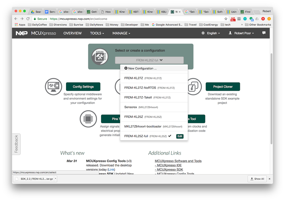

I visited Welcome to MCUXpresso | MCUXpresso Config Tools and created a new configuration:

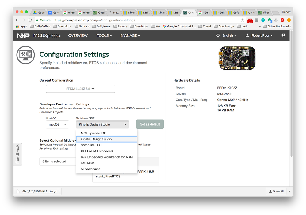

I selected "Config Settings" and selected "Kinetis Design Studio":

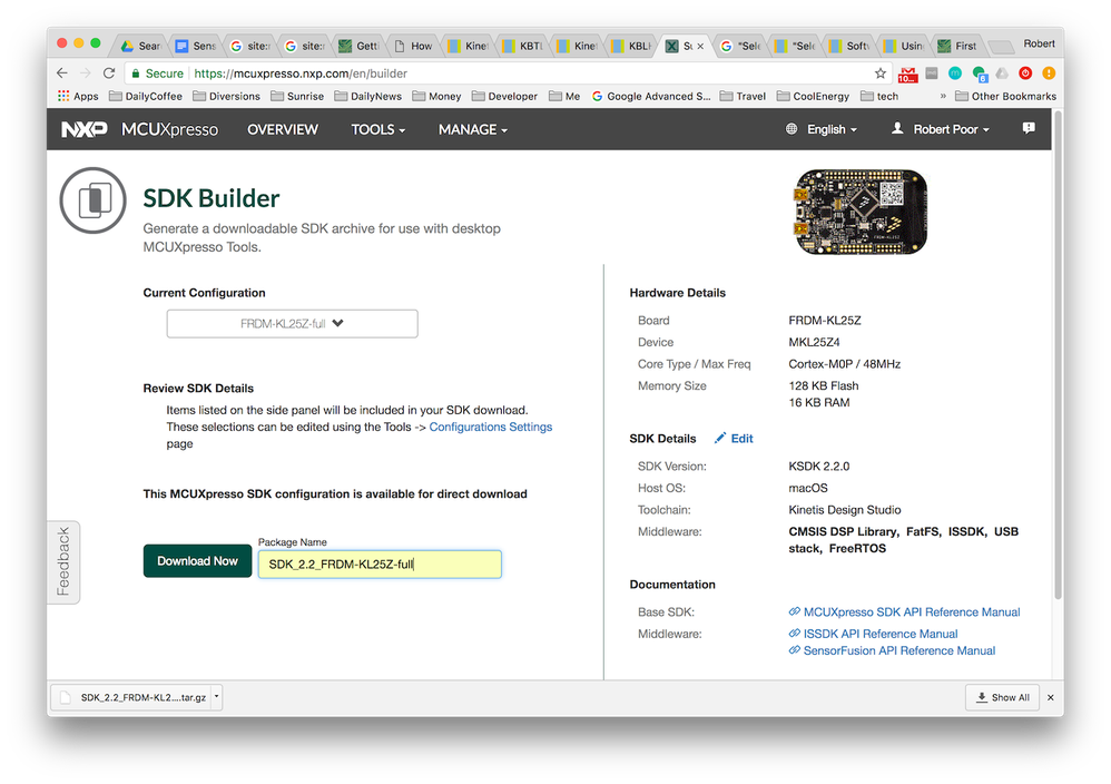

I reviewed the details, confirmed that it included "Toolchain: Kinetis Design Studio" before saving the download file:

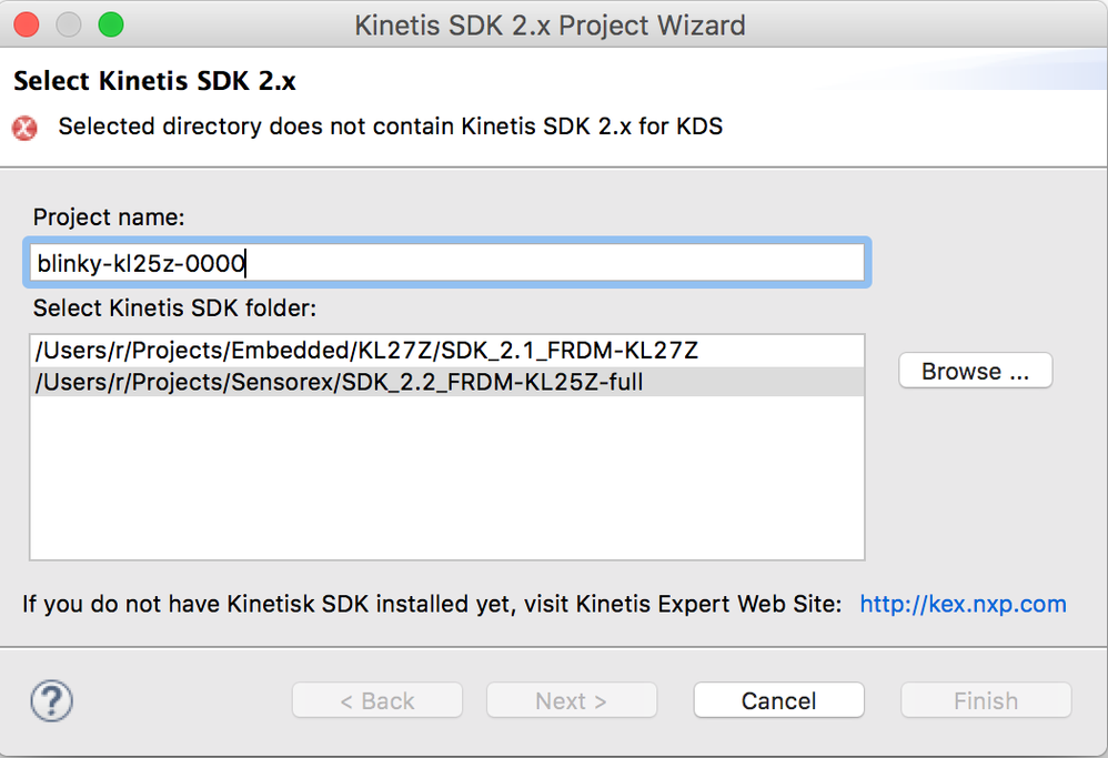

Then, in KDS_v3, I selected File => New => Kinetis SDK 2.x Project.
In the Kinetis SDK 2.x Project Wizard, I selected the SDK_2.2_FRDM-KL25Z-full directory, but was greeted with the "Selected directory does not contain Kinetis SDK 2.x for KDS" error message:
I'm baffled as  to why this is.  I'm attaching the FRDM-KL25Z_manifest.xml file in case that helps.

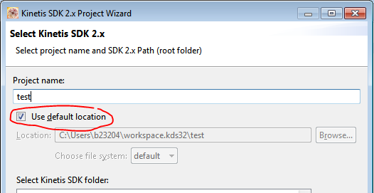

I have tried on my machine, I used SDK manifest that you posted and select the folder in New Project Wizard. There is no error displayed and New Project Wizard allows me to select processor or board.
I think New Project Wizard on your machine is not installed properly. Try to uninstall it and install again or re-install KDS. The last version of New Project Wizard contains check box to select default location - see attached screenshot.

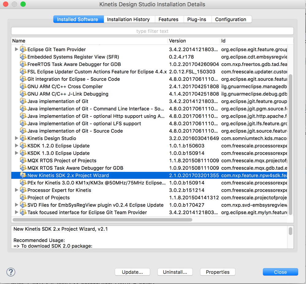

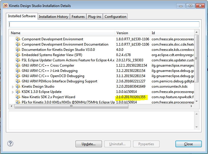

you need the latest version of new project wizard updated from update site. You can find current version in main menu - Help - About Kinetis Design Studio - Installation Details. Latest version is 2.1, see attached picture.
For instructions about update please refer to docs\Getting Started with MCUXpresso SDK.pdf document in your SDK package.

I'd already considered that possibility, and I even did a "check for updates", but my Project Wizard was already 2.1.0.201703201355, as you can see below.  Any other thoughts?
For what it's worth, an older manifest that DOES work starts with:
<ksdk:manifest xmlns:ksdk="http://nxp.com/ksdk/2.0/ksdk_manifest.xsd" ... >
And the recently generated manifest that does NOT work starts with:
<ksdk:manifest xmlns:ksdk="http://nxp.com/ksdk/2.0/ksdk_manifest_v3.0.xsd"  ... >

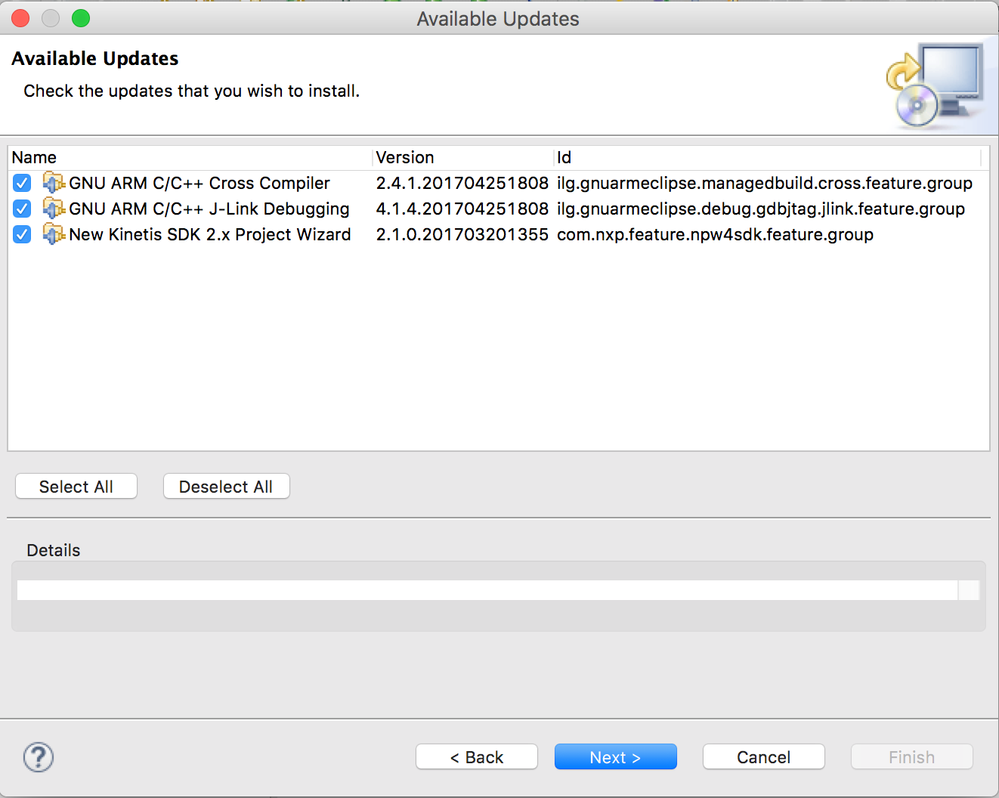

I tried removing / re-installing New Project Wizard but that didn't help.  I then reinstalled kds v 3.2.0 from scratch, and used "Check For Updates" to install the following packages (including the new Project Wizard).  Now it accepts the new SDK format.  I'm not sure what was wrong, but I'm marking this as solved.  Thanks!
