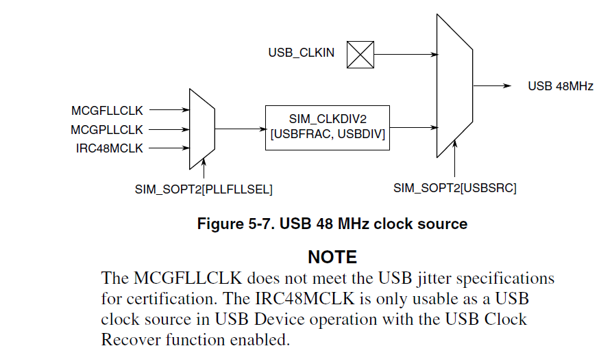

xiangjun_rong
This is the USB clock diagram for K22. If you use IRC48MCLK source, I do not think there is any problem after you change the system/core clock. But if you use MCGPLL clock as the system/core clock, after you change the frequency, there is issue. Pls check the SIM_SOPT2[PLLFLLSEL] and determine the USB clock source. Not that the USB must use 48MHz clock with low jitter.
Xiangjun Rong

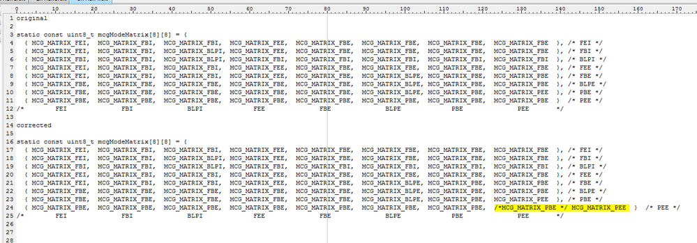

joebirch
I am using IRC48MCLK.
But I made a change to the KSDK that seems to fix the problem.
background:
I use CLOCK_SYS_SetConfiguration() to change the clocks when changing the power mode.
after calling CLOCK_SYS_SetConfiguration USB stops sending.
I isolated the cause of the USB failure to CLOCK_SYS_SetMcgMode()
Although I am in PLL Engaged External(PEE)Mode in both the old and new configuration
it first switches to PLL Bypassed External(PBE) Mode then back to PEE
I think there is a mistake in mcgModeMatrix[8][8]
If old is PEE and new is PEE it goes to PBE
I changed it to stay in PEE and USB rides through the clock change
Here is the code, can you tell me if this is correct
Joe
