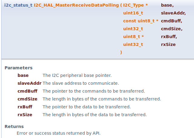

I use I2C_DRV_MasterReceiveDataPolling() that calls I2C_HAL_MasterReceiveDataPolling()
I find the docs:
in particular the third and fourth arguments.
I call
uint16_t addr;
uint8_t cmdBuff[2];
addr=0xf1ca;
cmdBuff[0] = (uint8_t)((addr>>8)&0xff);
cmdBuff[1] = (uint8_t)((addr>>0)&0xff);
I2C_DRV_MasterReceiveDataPolling(i2cEE_IDX, I2C_EEPROM_ADDRESS, cmdBuff, 2, pdata8, len);
Using a protocol analizer I can see that the first byte send by i2c (after the slave address), is correct, 0xf1. The second byte is not 0xca!
Debugging I follow the flow until I2C_HAL_MasterReceiveDataPolling() (lines from 440 in file fsl_i2c_hal.c):
   /* Send CMD buffer */
    if (cmdBuff != NULL)
        while (cmdSize--)
            if (!I2C_HAL_WriteByteBlocking(base, *cmdBuff--))
                /* Send STOP if no ACK received */
                I2C_HAL_SendStop(base);
                return kStatus_I2C_ReceivedNak;
The point is the line 445. There is *cmdBuff--, so the first byte tranferred is correct, but the second is out of the buffer (ideally at index -1).
I wonder if it is a bug, because the same decrement is also at line 554 (I2C_HAL_MasterSendDataPolling()).
If it is not a bug, I have to pass the pointer to the last element of a buffer (strange and counterintuitive), and the documentation should specify this behavoiur.
Unfortunately the example shipped with KSDK1.3.0 doesn't help me
best regards
Max

Development team told me that this bug is fixed in latest KSDK 1.3 version. Also, they provided me the fixed source file with this change (replace the -- by ++). I am attaching this file in case anybody want to check it.
Isaac

Looking at your post and it seems logical that the *cmdBuff-- should be incremented (i.e. *cmdBuff++) rather than decremented.
Have you tried changing it?

of course!
I have tried to increment and it works perfectly
And I tried to pass pointer to the last element of the buffer and it also works correctly.
So this is a bug in the source code, or is a bug in the docs.
It is strange that the decrement is replicated in two functions.
But it is also strange that no one noticed the problem until now.
And finally, if it is not a bug, it is strange to pass pointer to the last element of an array, and that this behaviour isn't undocumented.
