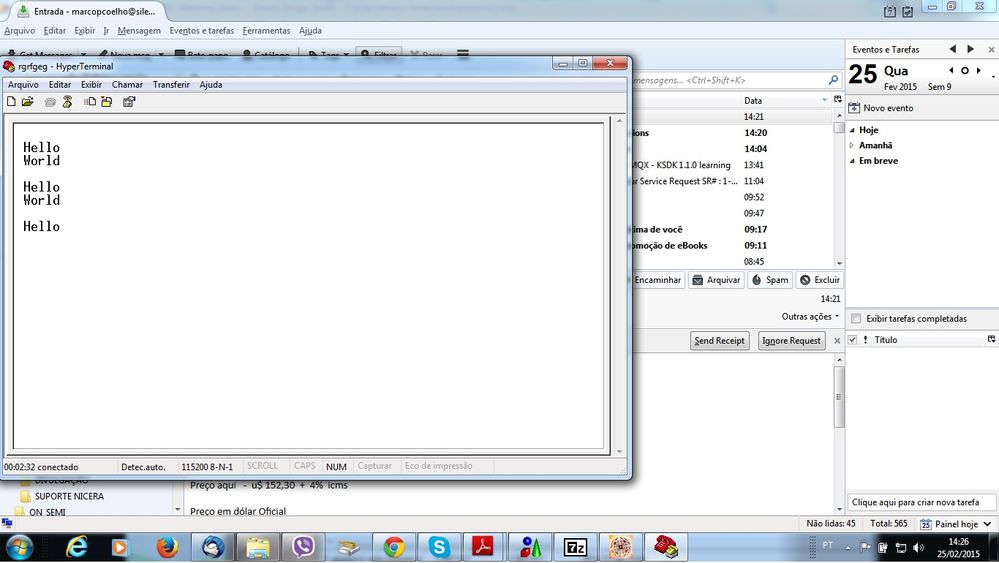

I just wrote a simple code with MQX - KSDK: I created two tasks; one prints out "Hello" and the other prints out "World" on a Windows Terminal. I used two semaphores to control the usage of the serial output by both tasks.
I don't know why after the fifth print ("Hello"), the tasks stop running and it falls into "Default ISR". I can't identify what could be causing that:

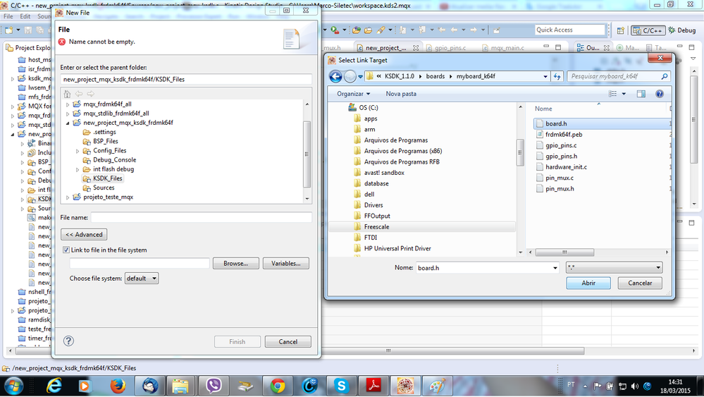

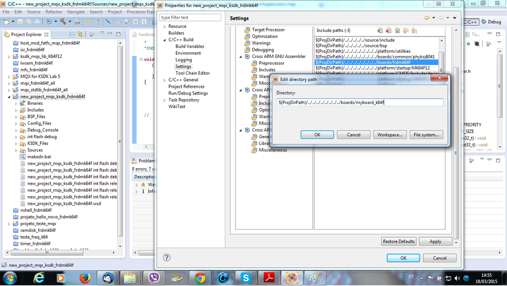

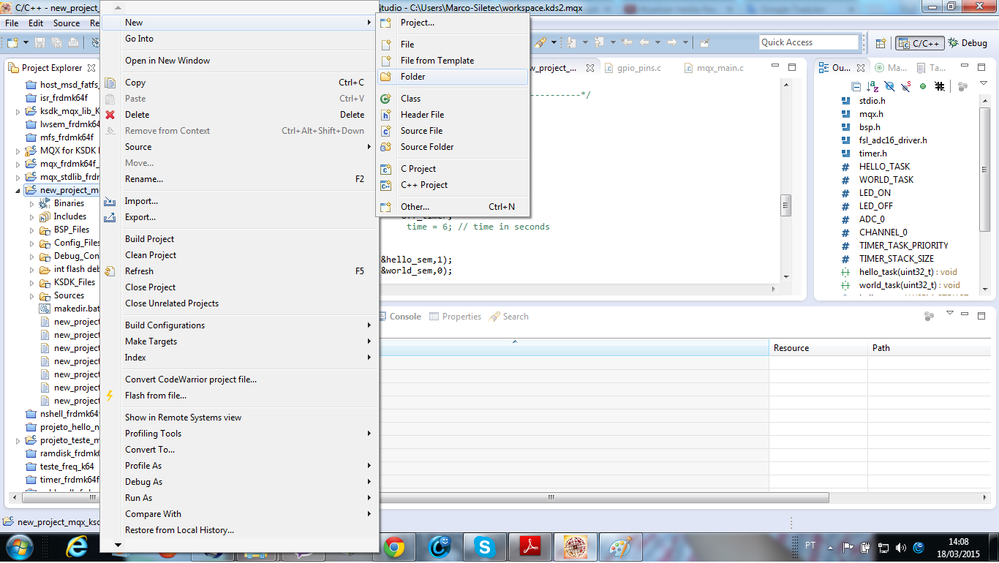

I would like to share with you a workaround I found in order not to mess with the original boards/frdmk64f folder files like gpio_pins.c, board.h, etc and get free to change them to meet my application needs. It may be helpful to other people in the Community.
1) I cloned (Ctl + C, Ctl + V) the "C:/Freescale/KSDK_1.1.0/board/frdmk64f" folder and renamed it, in my case, to "myboard_k64f" in the same directory, keeping the files inside with the same name:
2) Then, I created a virtual folder and named it "KSDK_Files" and included the linked files inside that folder. To do it, I right clicked on project's name, "New", "Folder". I filled the "Folder name" field with "KSDK_Files", clicked on "Advanced", checked on the option "Folder is not located in the file system (Virtual Folder)" and clicked on "Finish":
3) Right click on "KSDK_Files" folder. Select New / File / Advanced and mark the option "Link to File in File System". Click on "Browse" button and point to "board.h" file inside recently created "myboard_k64f" folder and click on "Open" to confirm:
4) Repeat the same procedure above in order to link to the other files: "gpio_pins.c", "gpio_pins.h", "hardware_init.c", "pin_mux.c" and "pin_mux.h". Do not link to "frdmk64f.peb" file. We won't use it in our case.

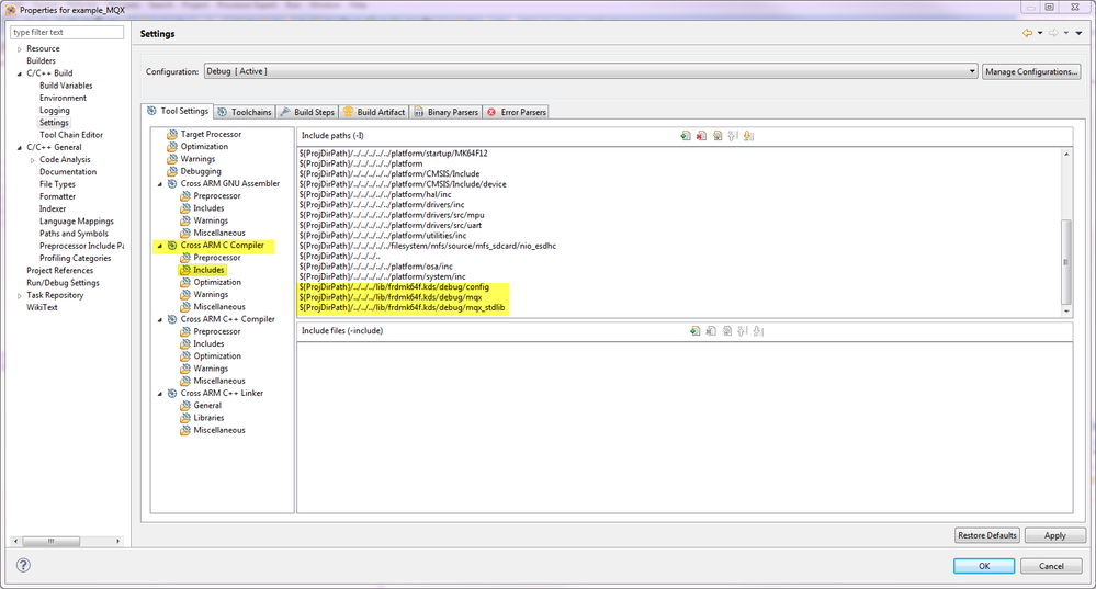

5) Now it is necessary to change the path which points to "frdmk64f" folder to "myboard_k64f" folder in "Compiler / Includes" and "Assembler / Includes" Settings:
5.1) First, go to "Project / Settings / Cross ARM GNU Assembler / Includes". Double click on the "...boards/frdmk64f" folder path and change it to "...boards/myboard_k64f". Click on "OK" and "Apply":
Repeat the same procedure above in "Project / Settings / Cross ARM C Compiler / Includes", rebuild the project and it is finished. Now you have you own board configuration files to do change acording to your board setup, without messing with the original ones.

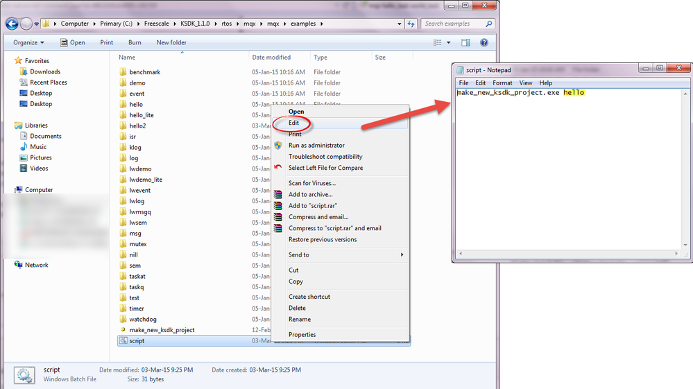

So, please go to the example hello from C:\Freescale\KSDK_1.1.0\rtos\mqx\mqx\examples\hello and replace it according to my attached code.
This solution works well, I tested as well.
If you don´t want to modify original demo, it is more simple to copy the demo and modify its copy.

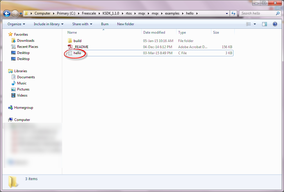

So, you can do it by e.g. Total Commander and replace the old name to new one, or you can use this very useful script, which creates Anthony Huereca.
Create new KSDK Projects
Just take a exe script (make_new_ksdk_project) and put it in your case into C:\Freescale\KSDK_1.1.0\rtos\mqx\mqx\examples
I also attach you the script.bat, which you execute for your creation copy. I set "hello" example, by double click on script.bat.

ivadorazinova
Hi Marco Aurelio P. Coelho,
I´m attaching it by the end of the previous post. It is called frdm_k64f_hello.zip and in this folder I attach you script.bat, script by Anthony and main.c
frdm_k64f_hello.zip
Please, try the process, which I refer to you above, and tell me. It looks you badly create a project.

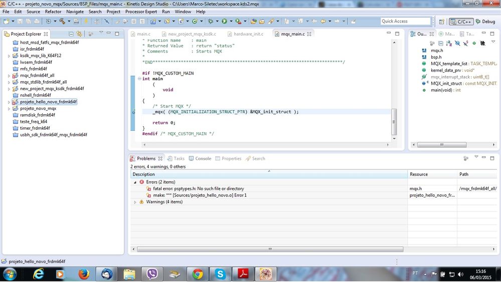

MAPC
Senior Contributor I
Hello, Iva

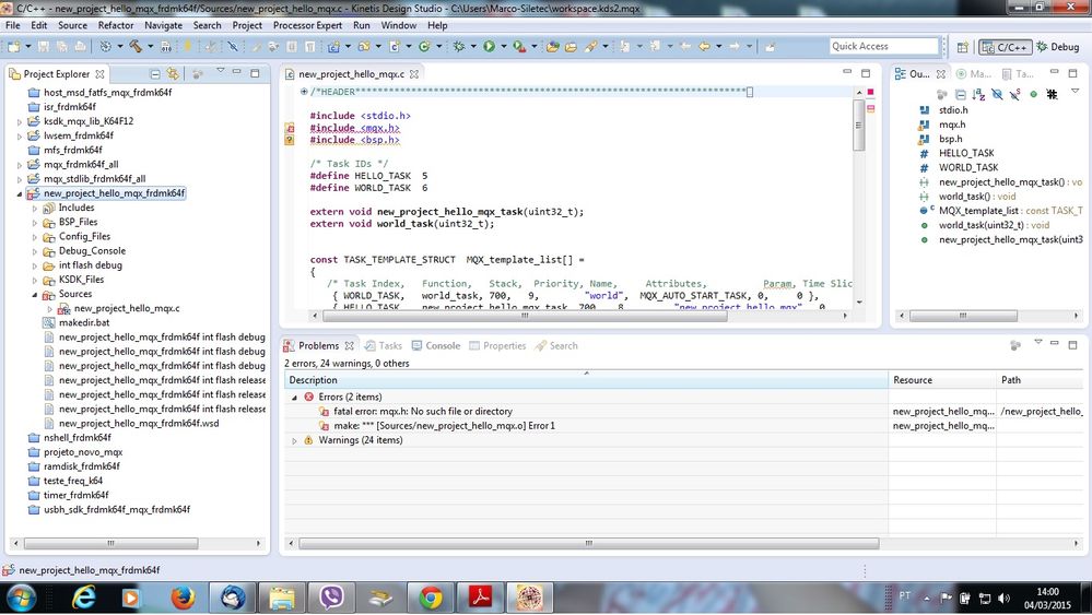

I just tested your solution and it really works with the script file, but only when you copy the hello project to the same location C:\Freescale\KSDK_1.1.0\rtos\mqx\mqx\examples and keep it there.
I tried to copy the hello project to another directory and use the script file to create a copy of the project there, but when I import the project to KDS and compile it, the following error comes up:
I would like to have the freedom of creating my project anywhere. One disadvantage of the script method is that the files from the examples are linked to the libraries where they are located at and if you need to make any modification, you change the content of the original files and that is not good. The method proposed by Carlos Musich copy the files so you can change them any time you want.
The author of scipt solution, Anthony Huereca says that it is possible to move hello project to another directory and make a copy of it there, but I don't know if I there is a way to do it through the script file or there is another way to do it. Were you able to do it on your side?
I also tried to remove the linked folders, create new folders and copy all the files and libraries manually, by following the Carlos Musich's method, but it failed, as well.
Thanks.
Marco

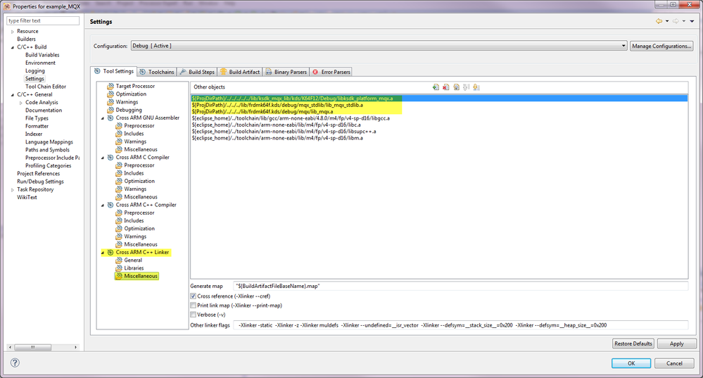

ivadorazinova

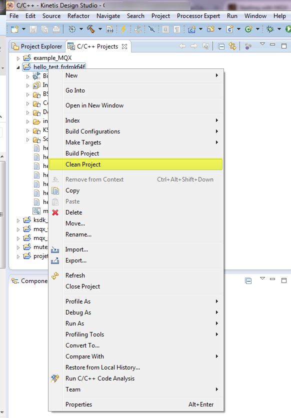

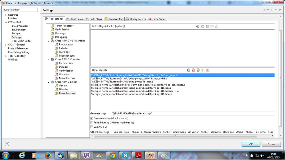

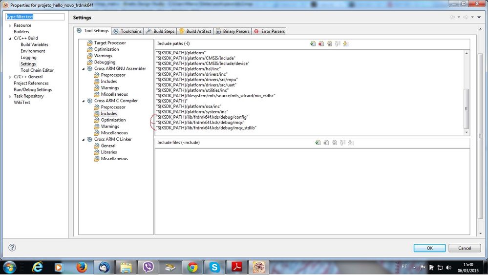

It looks you have do not include the libraries (mqx_stlib_frdmk64f, mqx_frdmk64f and ksdk_mqx-lib_k64f12)
Please, check it according to this Compiler and Linker settings in KDS. After that please clean your project and build again.
You have to set the paths to your project and therefore you cannot move your project in your way. So modifying the demo/example is the best way how to avoid conflict.
If you want to copy another project, edit the bat file, type the name of example, which you want to copy, save it and execute the script.bat and type the name of new project.
The name must be different.
I tested on my side and it works without problems.
Yes,it is possible to move the script to another example folder. You can copy the script e.g. to C:\Freescale\KSDK_1.1.0\demos

MAPC
Hello, Iva
Thanks for your dedication to help me so far.
The script solution works very well when I copy hello project inside examples folder, but when I try to copy the same project to a directory other than C:\Freescale\KSDK_1.1.0\rtos\mqx\mqx\examples\, it fails, as you can see on the screenshot bellow:
I had to set the paths to ${KSDK_PATH}, and the libraries you mentioned above are already there:
It looks like the best solution so far is the script solution, keeping the copied project at examples folder. If there is not a better way, I can adopt that as a temporary solution. I will try the Carlos Musich's method once more, although it is a very tiring process.

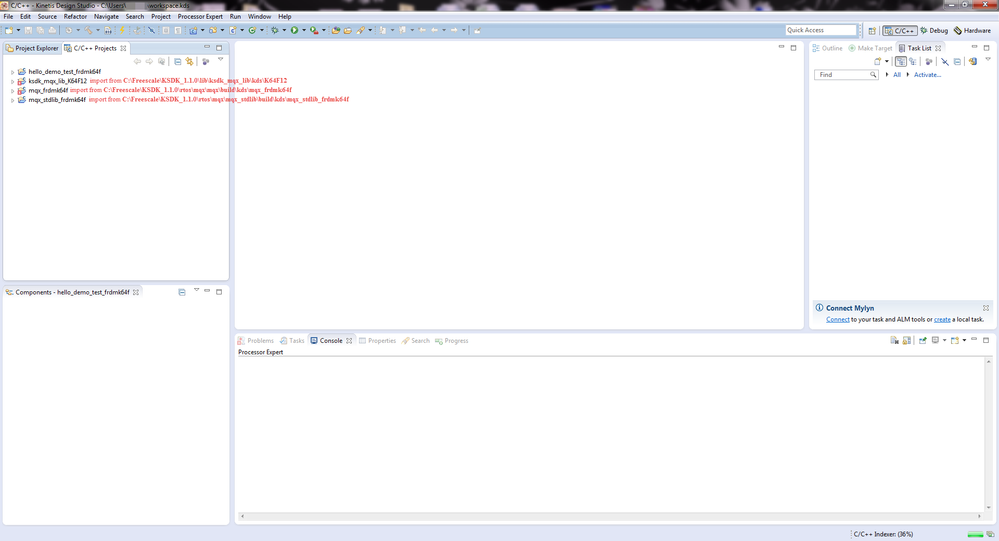

ivadorazinova
Please, I´m working on short tutorial for you for checking whole procedure.
Hopefully, during the day, I have finished the tutorial and post it to Community.
Please, check the libraries included to the project. I also write you the paths to the libraries.
First of all, build the libraries and after that build the project. It works.
