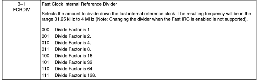

I try to execute this call with different values of fcrdivVal, the fourth parameters in the function.
    CLOCK_HAL_SetFbiMode(MCG_BASE, kMcgDcoRangeSelMid, kMcgInternalRefClkSelFast, 5, CLOCK_FllStableDelay, &outClkFreq );
It execute correctly with values from 0 to 5. The clock is 125 KHz with a value of 5.
If the fcrdivVal is 6 the clock is updated (32KHz), I see on the scope as CLOCKOUT, but the debugger looses the control.
Is it normal???
Solutions???
Thank You

Hi Pietro,
Why do you change the divider when you use the FBI?
If you go to Reference Manual, page 593
http://cache.freescale.com/files/microcontrollers/doc/ref_manual/K64P144M120SF5RM.pdf
so, the value for fcrdivVal = 6, output frequency cannot be 32KHz.
Because when the value is 5, 4MHz and Divide Factor is 32, is 125KHz. It is right.
BUT: when is the value 6, 4MHz and Divide Factor is 64, it is 62,5KHz, not 32KHz.
(4MHz : 64 = 62,5KHz)
As it is written in the Reference Manual : you have not change the divider when the Fast IRC is enabled.
Please, look to SIM Module, Register SIM_CLKDIV1->OUTDIV4 what is your frequency divider for flash memory.
Iva

Hi Iva
Yes I should not divide in such condition. That's a good point.
Thank You
