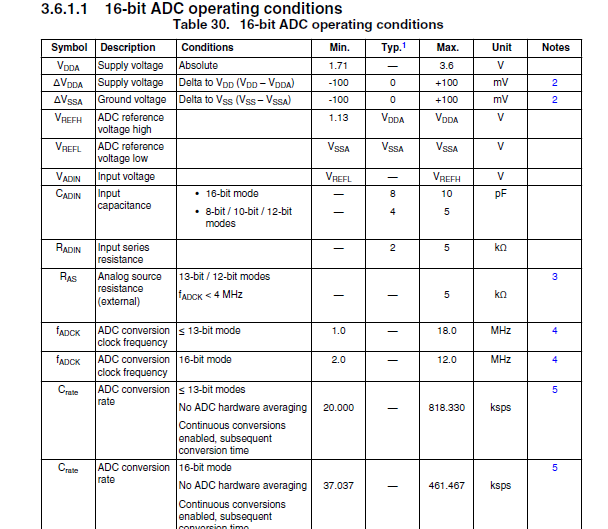

xiangjun_rong
I suppose that the K64 ADC sampling frequency can not reach up to 1.2MHz, the maximum ADC sampling frequency is 818KHz with 13 bit resolution.
If you want to get 1.2MHz sampling frequency, I suggest you use KV5x, the KV5X has cyclic ADC,  the cyclic ADC of KV5x can reach up to 1.2MSPS.
Hope it can help you.
Xiangjun Rong
