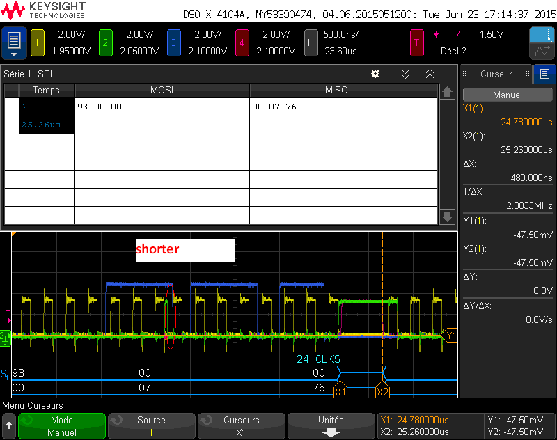

Hello Freescale community,
I use Kinetis Design studio 2.0.0, MQX KSDK 1.0.0 with Processor expert, (uc MK64F),
I realized SPI communication  using SPI0 and two channels DMA for Tx et Rx. I talk with a multiports (ADC,DAC, GPI,GPO) component at 4MHz.
I chose sck non-continuous for the configuration of the SPI
The frame format is 3 bytes : One for CMD, one for data LSB and one for data MSB.

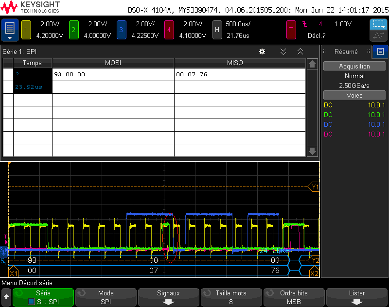

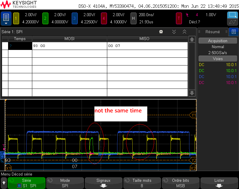

I have a problem with reception of the first bit of each new byte because the sck signal has a strange behavior : the gap between two clock cycle is good but the gap between the 8th bit and the first bit of the next byte is different. You can see the behavior on the following screenshot :
with a zoom we can very well if the clock difference :
What the problem, Can you help me ?

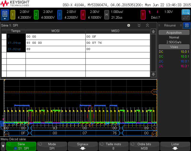

I have found a solution for not having problem reading the first bit of new byte using functions :
static inline void DSPI_HAL_SetModifiedTimingFormatCmd(uint32_t baseAddr, bool enable)
and
static inline void DSPI_HAL_SetDatainSamplepointMode(uint32_t baseAddr,dspi_master_sample_point_t samplePnt) with "kDspiSckToSin_1Clock"
But signal MOSI is modify and I think this is not a properly operation
You can see with this modifications :
Please can you give me some advices to resolve this problem ?

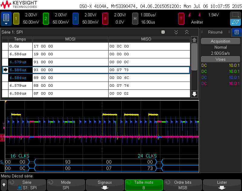

I found the solution, I use the function DSPI_DRV_MasterSetDelay with argument "kDspiPcsToSck" and I put the little delay I want between each bytes.

I have already use this function for apply special delay, but the delay  "kDspiAfterTransfer" allow to modify the delays between two activation of the chip select and not between the 8th bit and the first bit of the next byte.
In this image you can see the delay of 400 ns I apply :
But my problem is still present,
you have very well understood my problem : the time between Byte is shorter than the time between bits ,
Please help me ?
